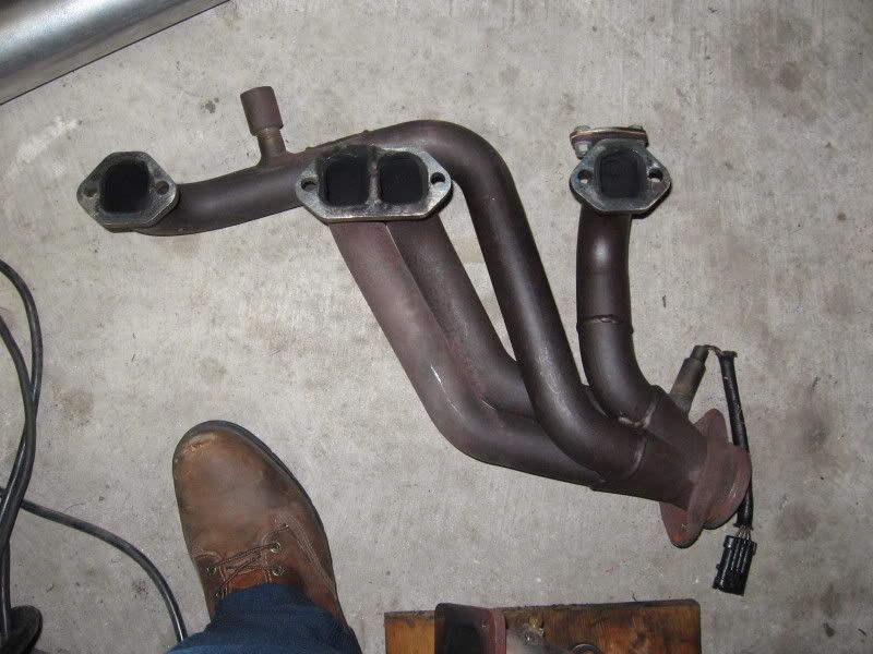

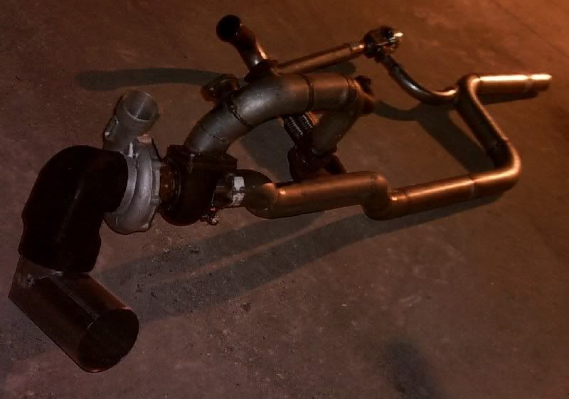

RealQuick's Avatar
Joined: Feb 2002
Posts: 5,645
From: Bridgewater, MA
Originally Posted by engineermike
A twin will spool very slightly quicker than a single, but no more power capability if they are sized correctly. A front-mount will spool quicker and make more power than a butt-mount.
Realquick posted pic's of mine a while back, so you can search under his name. However, he's built a couple of kits with the same general layout. He posted some pic's very recently of one.
Mike
Here ya go Mike:
Old Sep 9, 2007 | 10:06 PM
IROCThisZ28ForLife's Avatar
Joined: Feb 2007
Posts: 567
From: Queens, New York
wow thats amazing looking....cant wait
