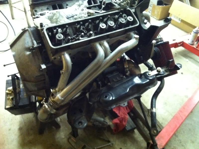

I let Shownomercyz28 chime in with specifics, but basically he bought one of my used PT88 hotparts that i reworked for him, and will be sending him a complete kit. He will be running a 383ci (single plain intake, he can give details).
The kit consists of the following:
Precision T76GTS
1 5/8" headers (reworked BBK's)
2.5" crossover
3" up pipe
3" downpipe
JGS 50mm wastegate
JGS60mm BOV
31x12x4" A2A IC
3" cold side piping
RPS couplers and T-bolt clamps
oil lines
Hotside Mockup

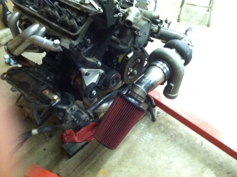

Re: Shownomercyz28's Turbo Build... courtesy of LT1Boost
Cold side Mockup

Old Jan 7, 2012 | 07:08 PM
ShownomercyZ28's Avatar
Joined: May 2008
Posts: 232
Looks good Jon!

whats the hp goal
Old Jan 9, 2012 | 09:19 AM
RealQuick's Avatar
Joined: Feb 2002
Posts: 5,645
From: Bridgewater, MA
His goal is low 10's @ track... so somewhere in the 650-700rwhp.
