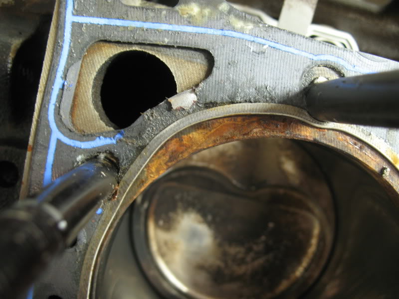

This weekend I decided to drop the engine. Tore everything down to the short block. The oil has water in it. The head gasket looks messed up on the passenger side mostly. Tell me what you think happened here.
In this picture is looks like the gasket was pushed outwards.
This looks like the gasket is distorted and not straight up.
I don't see damage to the pistons from the top either.
