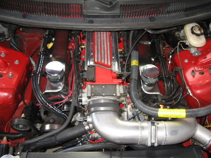

hey guys i was wondering if anyone makes a pipe to go directly from the blower to the intake. i am not running an intercooler. i am running a water injection mixture with methanol with a kit form snow performance. if anyone has made there own or would have pictures of one that i can buy that would be great. thanks guys

Here is a kit I found however you probably won't need that many pipes. You can also by this stuff individually on ebay. Clamps are included but gates hose is better than the stuff they sell in those kits. You have to find a 3-3.5" coupling for the MAF. I've seen alot of people use a trickflow cast elbow. Just search ebay with "3 intercooler pipe"

I flipped my blower straight up and welded up 2 3.5" 45 degree angle pipes. Fits perfect. Send me a PM with your email, I will send you a couple pics.

Custom made with a trick flow elbow, a 3.5" 90* aluminum tube, and a 3"-3.5" 45* rubber coupler.

Very clean install Ponyhunter. Who does your welding?

Thanks! I have a guy local here in KC that did my tubing, but I've also got a very good friend of mine in Indy that has a chassis shop-he's done all my cage and chassis work.
