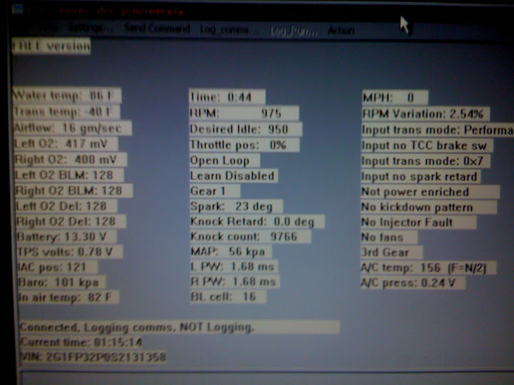

Now this shot is from LT1 Edit, but oddly the o2 values are almost even. Typically the two are WAY off. I didn't log it at all, but I watched the two bounce around.

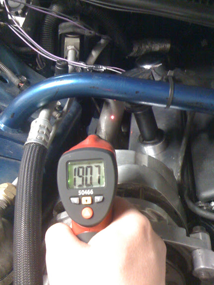

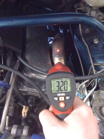

The Driver's Side primaries quickly climb to the ~350 degree mark.
But on the other hand, the Passenger's Side primaries stay 190-200 degrees. This is where the differing o2 values really show (I wish the snapshot I grabbed showed the differences, but it's idling so the o2 values are all over - but they are typically off).

MAP reading looks wrong at idle... should be in the 60-70 range.
Spark pug wires are wrong or valvetrain needs adjusting

Have you shot a temp of each cylinder on the passenger bank 2?
