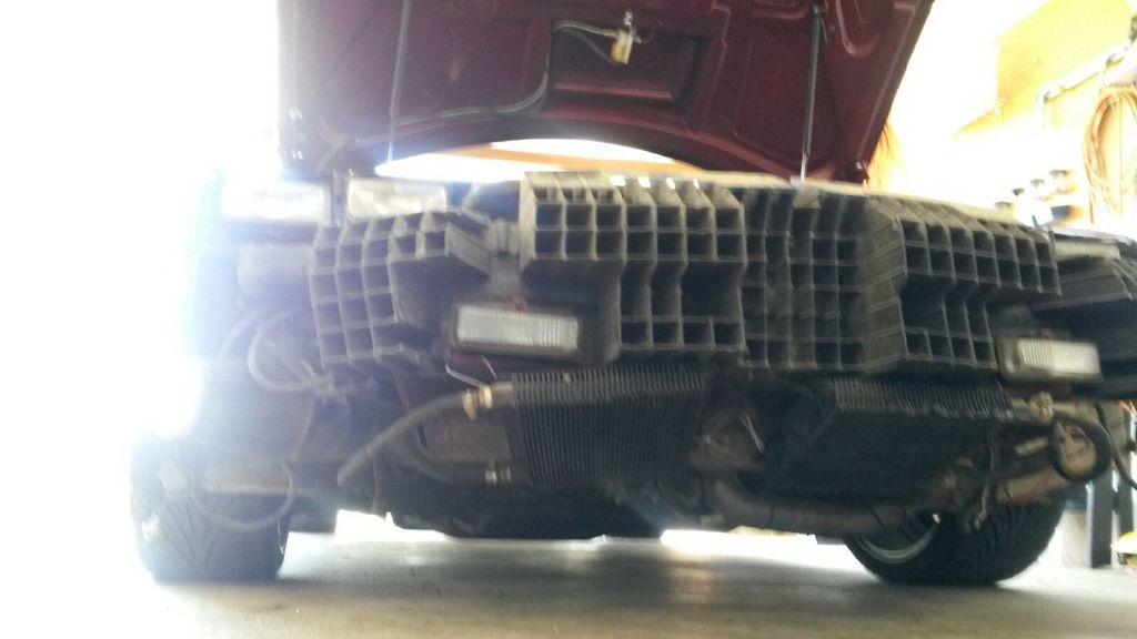

I have circled where I have 2 heat exchangers below.
He stated that one is for the intercooler system and one is for the transmission cooler.
The transmission cooler unit is located at the rear of the car just in front of the rear axle.

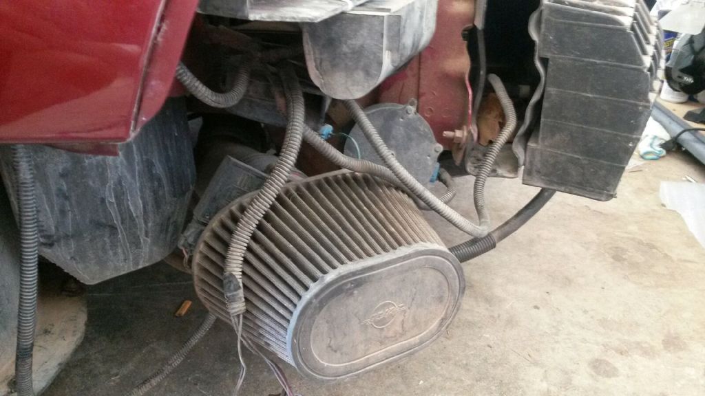

Here is a pic of the front setup. You can see where my heat exchangers are mounted as well as the air intake. Sorry about the poor quality and no, the heat exchangers are not zip-tied normally. Just keeping them from dragging/hanging on the ground.

From the looks of those pictures the heat exchangers are in the direct path of the air feeding the radiator. I'd venture to say that you're either dumping super hot air onto the hot radiator or you're just not moving enough air into the radiator. Or both.
You might want to try moving the smaller exchangers to the splash guards in front of the wheels with a set of small fans or scoops (check out Procharger's twin intercooler setup for ideas) to see if that will help the problem. You'll have to get a bit creative with the air filter though or just stick one directly on the turbo. That's where I would start anyways.
