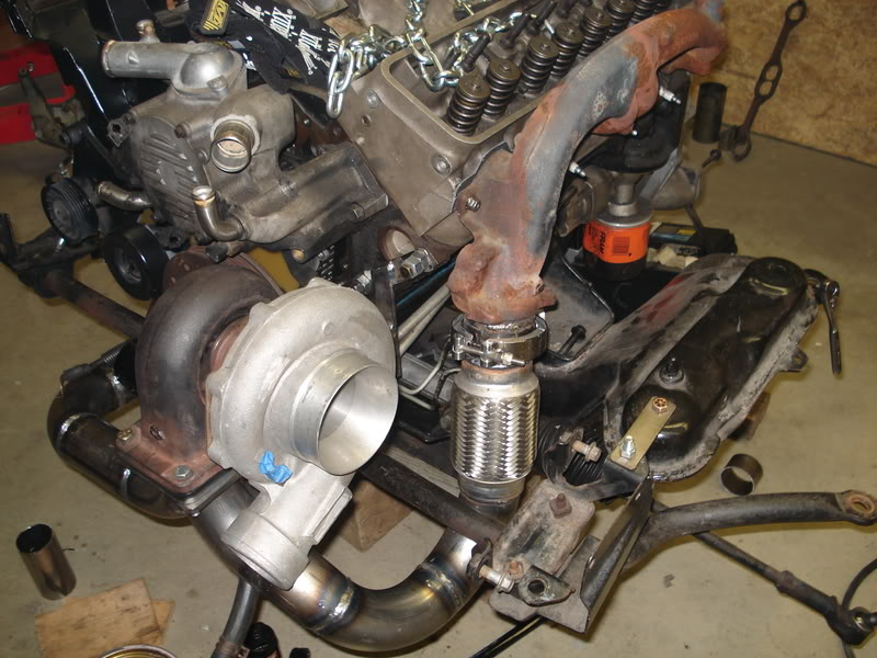

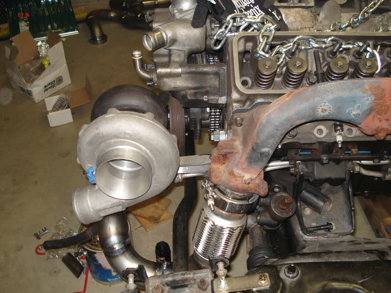

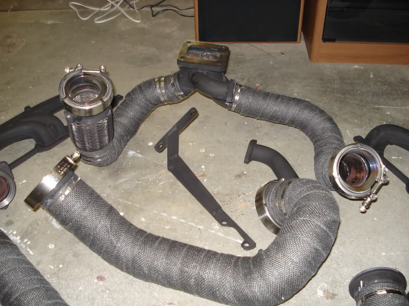

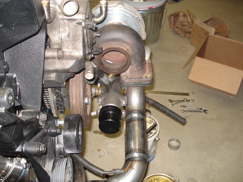

Well guys, I am waiting on parts to complete the TT setup. In the mean time, I decided to build the Cast Manifold Budget Kit (complete kit with a TC 76). This is a budget kit for $5000, but you'll have to delete your A/C. Not a bad price for a kit that will support 600-650rwhp. Here are the first build pics so far:

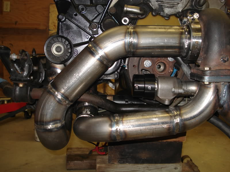

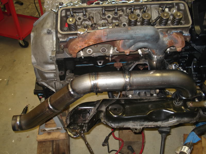

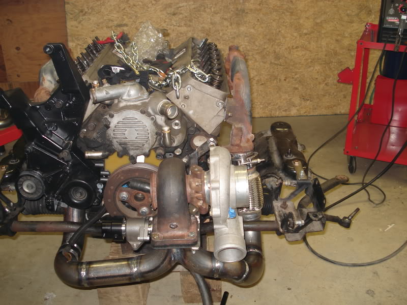

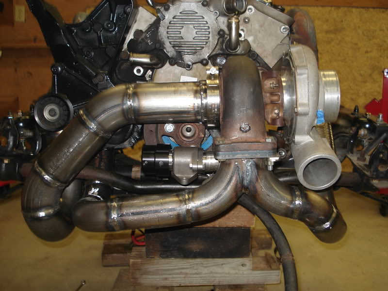

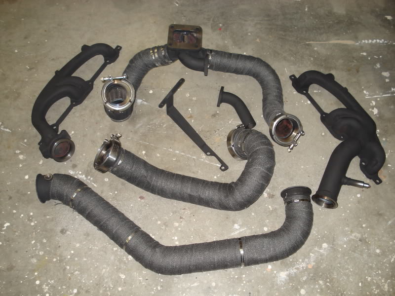

Some more progress on 3" DP:

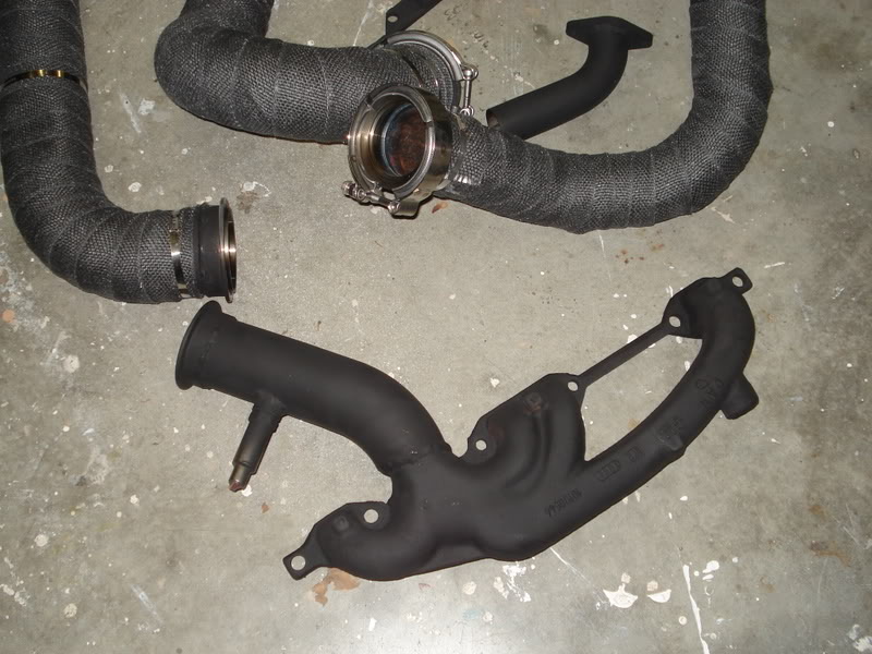

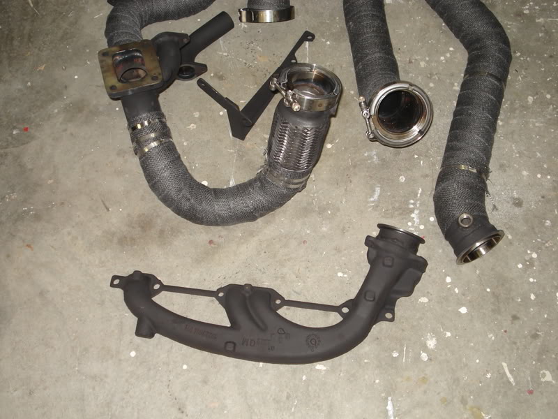

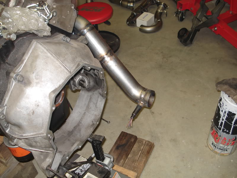

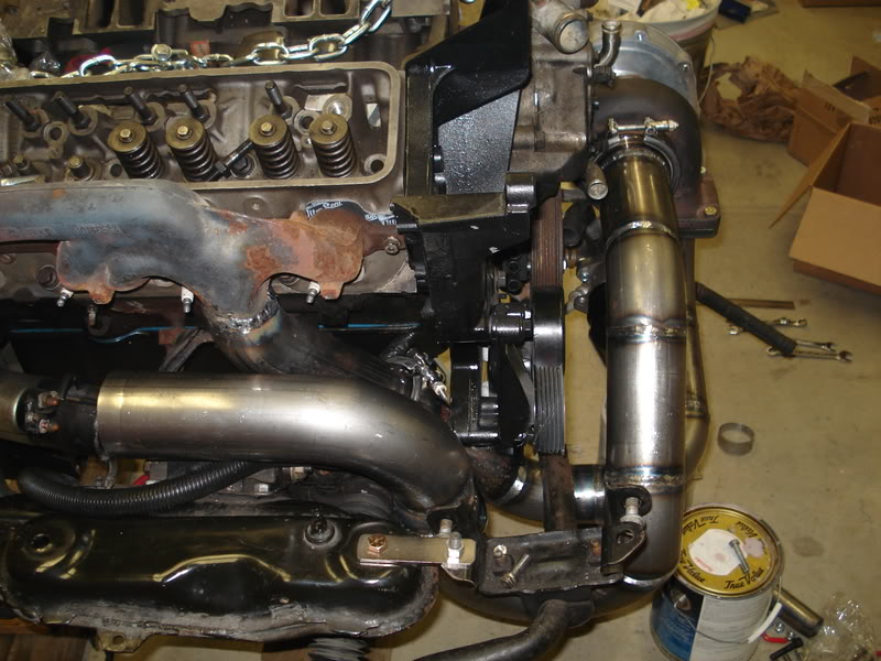

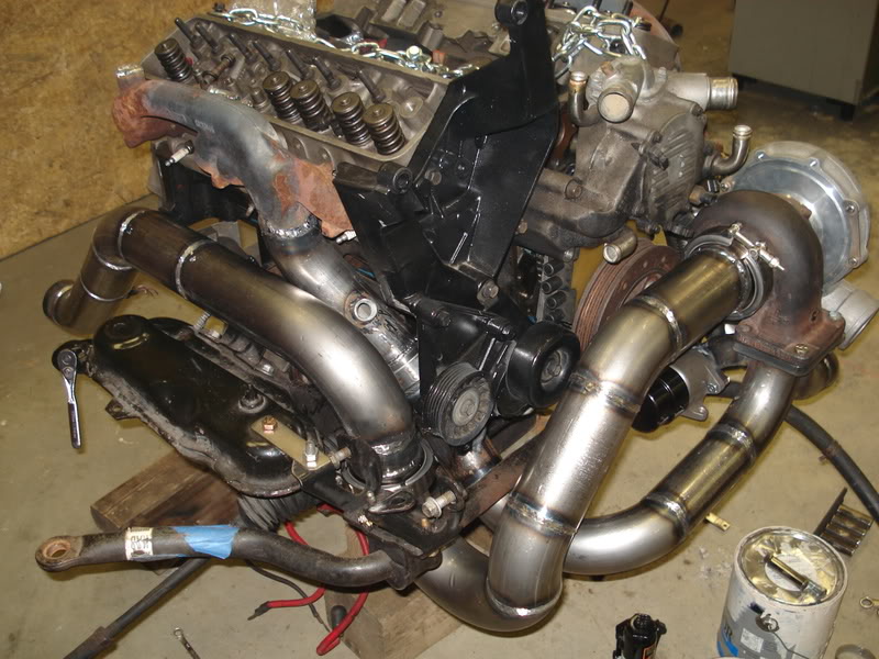

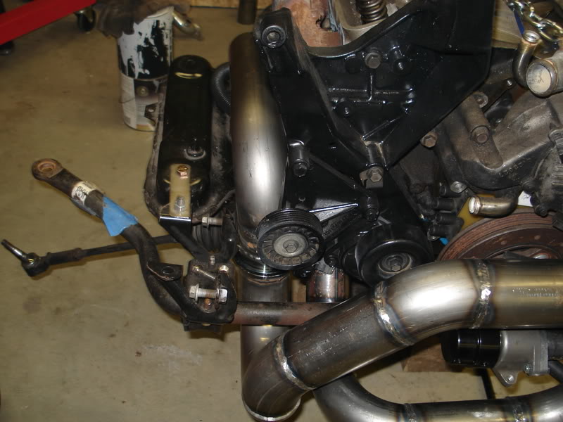

Some final pics before paint.

Old Oct 13, 2008 | 05:07 PM
RealQuick's Avatar
Joined: Feb 2002
Posts: 5,645
From: Bridgewater, MA

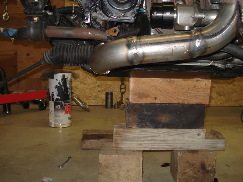

Old Oct 13, 2008 | 05:22 PM
jsetzer's Avatar
Joined: Feb 2004
Posts: 2,182
From: Moore OK
Looking good.
How bad/hard is it to weld to the cast?
My friends won't touch it but I have wanted to try this for a budget build myself sometime.
Old Oct 13, 2008 | 06:02 PM
RealQuick's Avatar
Joined: Feb 2002
Posts: 5,645
Originally Posted by jsetzer
Looking good.
Its not bad. You should use a hand held heat source (propane torch) to heat before and after you lay the welds. Also, you need the welder turned way up, so you can see the weld melting into the cast iron. if the weld bubbles up ont he surface of the weld, then you arent penetrating enough. Grind it flat and do it again.
Old Oct 14, 2008 | 07:59 AM
jsetzer's Avatar
Joined: Feb 2004
Posts: 2,182
From: Moore OK
Thanks, I'll give it a try sometime.
