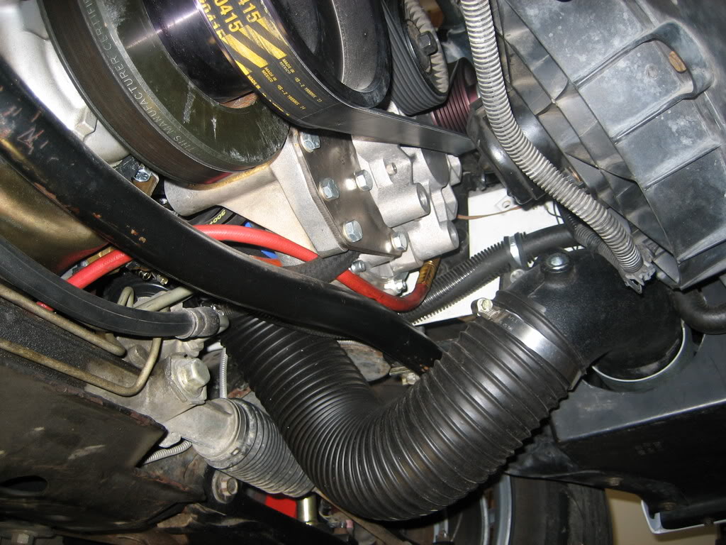

I use the Fluidamper with my Vortech T-trim and I love it and have had no problems. The weight of the piece really has no affect since it's a neutral balance it's not like it adds any more stress to the crank than the blower crank pulley itself.
To use it I had to use a lathe and open up the inside of it so that the vortech balancer would center itself plus I enlarged the 3 bolt holes in the balancer and retapped them to accept larger bolts to hold the crank pulley in place. I actually use a custom ASP crank pulley but I had them build it exactly like the factory Vortech piece just in a larger diameter.
Honestly it was a ton of work to modify it to work. I'm not sure i'd trust a machine shop to do the lathing, drilling, and tapping. I did it myself since I have access to these tools in my dad's shop.
But to answer the original question, yes it has been done and it will work. It just takes some modification. Here is the only pic I have.
