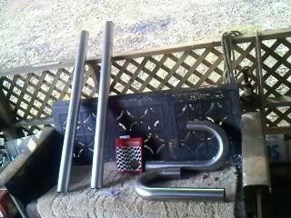

got some parts in today

that was only $150. 8ft straight pipe 2 j bends 6' of -3 hose and 2 90* fittings. im gonna try to get the turbo mounted on sunday

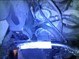

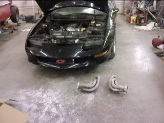

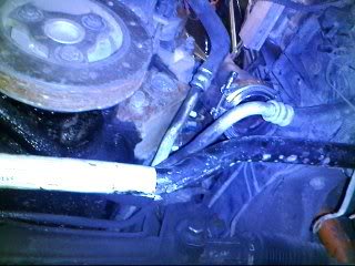

made some progress
