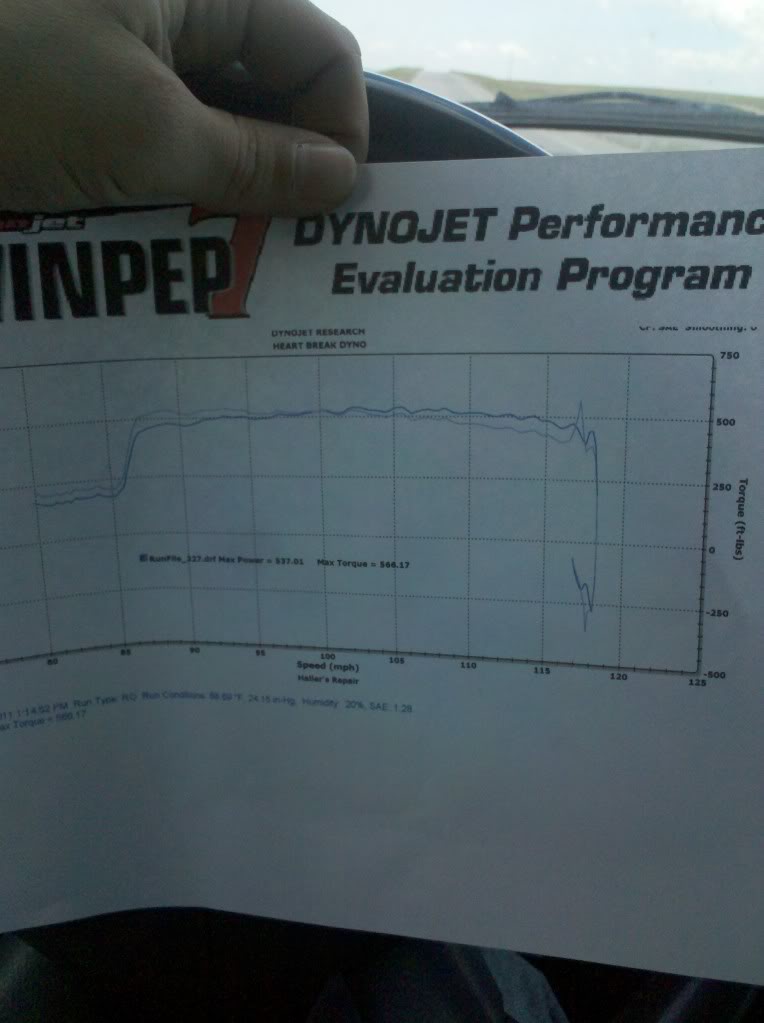

537rwhp and 566 rwtq. Overall I'm pretty happy even though the numbers are kinda low for my setup, I never thought I would own a car with this much power
There are a few things that I think are holding me back.
1. Stock throttle body and intake, would like to go with single plane someday.
2. The shop in Cheyenne where I had it dyno'd has only had the dyno for a couple of months and they didn't have a fan to put in front of the car, so basically it would be like running an un-intercooled setup right?
3. I've done a lot of tuning on the car, but only in the low rpms so it would be nice to drive around. It's only running 15 degrees timing and is pretty rich I should have done a log on the run, but I plan on booking some tuning time once I learn how to tune a fi car at wot.
4. The setup should handle more that the 14 psi that it's at. I'm going to order some waste gate springs someday.

Also how high did you spin it? I would the think the turbo 355 would like the very high revs. It would be nice to have a hp/tq vs RPM graph instead of mph...

Don't get down over dyno numbers- the same car can read completely different on dynos- even the same 'brand'. There is no industry standard to calibrate them. Injuneer has posted an article that proves the inconsistencies...
All that matters is you are happy and the car is running strong...don't rely completely on dyno-queen numbers.

Thats most of it I think. Do any of you know how much not having a fan in front of the car while it was making the run would hurt me?

Not a lot unless you made a bunch of back to back runs- once your intercooler is heat soaked it does nothing except add a little resistance...but when running high boost even a huge fan can't keep the intercooler temps down...
Easiest way would be check your air intake temps if you have a way to monitor them-

Oh no lol your printout is plotted against mph instead of rpm. Do you have one with rpm?
What is your compression ratio?
I wouldn't bother with a new throttle body (or intake). I'm running the stock throttle body and I have no doubts the engine will still make over 700hp on <15psi.

I forgot to get one with rpm instead of mph. Compression is around 8.5:1.

The graphs for hp/tq also don't look very smooth. What type of ignition are you running? I looked through the list of mods but you didn't mention anything.. Are you still running an optispark?
If you look at the graph there seems to be a huge spike at the end of the tq curve so 566 tq is not an acurate number. The hp/tq curves seem to peak at the same level so 530-540 torque is probably more accurate imo

Like I mentioned on ls1tech... 15 degrees of timing is way low for 14psi (especially with that low of CR).

yeah from what ive read it seems yer heads are likely on the lrg side for this setup, as well as low timing, and the compression isnt really helping for that low of boost. Get the boost up and a tad more timing and I think youll have a monster on yer hands

Any idea on how much boost I could run?
Realquick, you said I could run up to 26 degrees on ls1tech I think. I'm going to assume thats just for 14 psi though. Would it be ok if I pm'd you my timing table someday, whenever I get around to working on the car again. I would like for you to look at it and let me know how you would set it up, as I'm very new to tuning and really don't want to blow it up. Thanks
