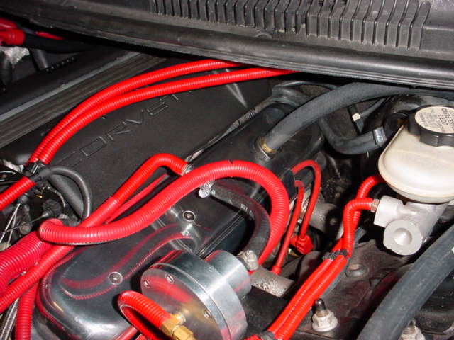

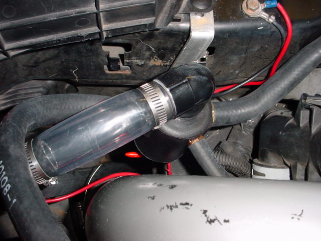

you need to make a good evac system for it, I took a breather tank from jegs one that normally has a breather filter on top of it, I mounted that to the rad support, I drilled a hole in each valve cover and ran a 3/4 inch hose from each valve cover to the tank, I also ran a line from the PCV valve to the tank, instead of the filter I ran a 1 inch hose down to the inlet of the super charger I used the hole where the factory recerculation valve went in the line sence I have a BOV on mine, that way any oil gets cought in the tank and the extra vapor just gets sucks back into the motor and burnt, I was blowing oil out of my dipstick tube and that compleatly solved my problems. no more oil leaks after that, a vaccum pump would be even better but that costs money and the way I did it worked.

Thanks lethal 93ta for the advise. I may have to do that on the new combo. Do you have any picks of the set up? I still think I have lost the rings due to the boost used. I will look at it when I get it out.

it wasnt purty on that set up, when I put the new motor in this time Ill probably use all braided line.
this is right behind the driver head light

I see you still have the fmu. I had Bryan from pcmforless tune around mine and it really helped the power and drivability. My new combo will be 60lb injectors and 12 psi hopefully. Thanks for the pics. I will be in touch when I get my new motor in if that is ok.

Is there an alterative to this remedy? Sounds like you did your homework on it. Thanks for the pics as well.

its just basic, whne your pushing oil out of the breathers and dip stick you have to much crank case pressure and you have to get rid of it, thats about the only way to do it, the stock rings will have some blowby and thats what happens if you dont vent everything.
