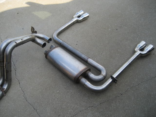

Thinking very seriously about getting this Bassani True Dual setup for my LT1.
Yes I know its nearly a grand but I can sell my Borla adjustable catback and cutout to reduce the hit.
My question to you guys that have this on a LT1.
1. Even though this is marketed toward the LS1, how well do the front pipes interface with your LT's? FWIW I have LPP's which are similar to the Kooks.
2. Where did you purchase it?
3. Any regrets?

The tips are not cut even. I don't think it's worth that.

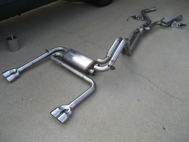

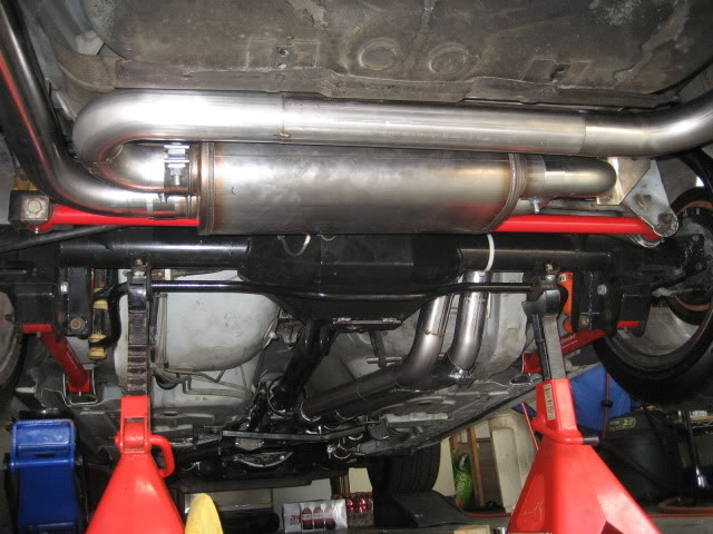

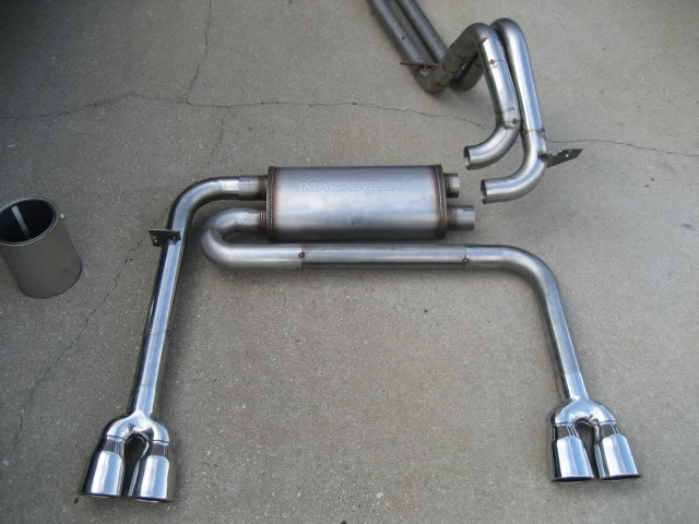

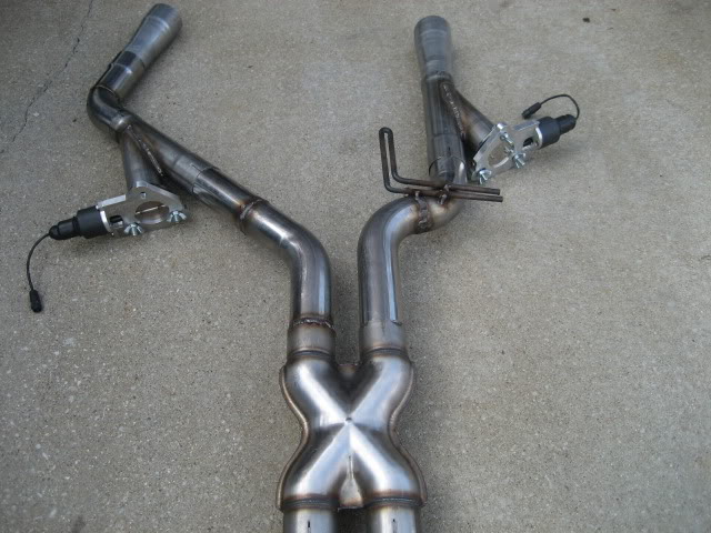

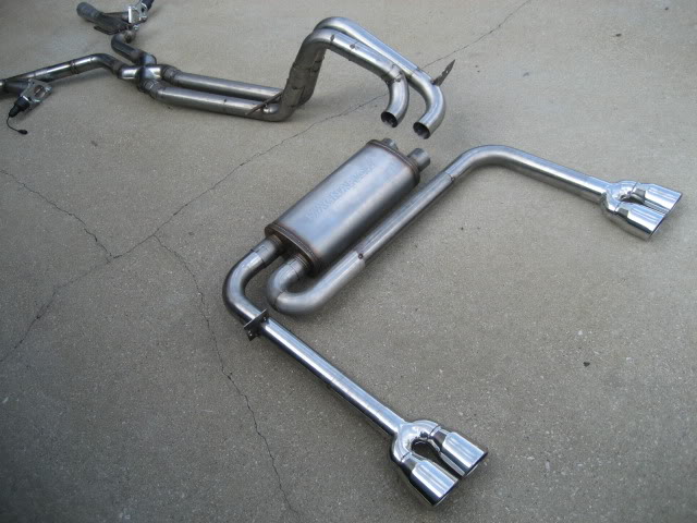

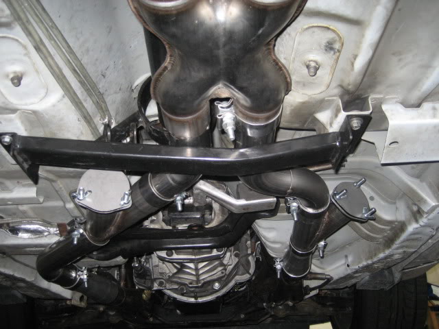

In the process of designing mandrel bent true duals for my ride.
I am wanting to build a 2.5" pipe setup to ensure I get max performance without out going overkill for my engine specs. I don't think I really need 3" pipes to the rear bumper. I also want the ability to switch between catalytic converters and "cutouts" in rather short time when I feel the need.
The overall design will look very much like this $1000 Basanni setup, but better:
This is what I have in mind currently:
  • 2.5" catalytic converters or "cutouts" right behind the collector that are easily switchable.
  • 3" to 2.5" reducers to the 2.5" dual pipes with the X-pipe located just after the short TA mount.
  • 2.5" in front of the x-pipe.
  • 2.5" pipe back to the dual in/dual out Magnaflow muffler in stock location.
  • 2.5" pipe from the muffler to each side under the rear bumper topped off with some nice stainless dual oval tips.

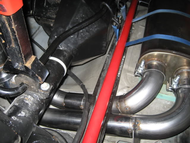

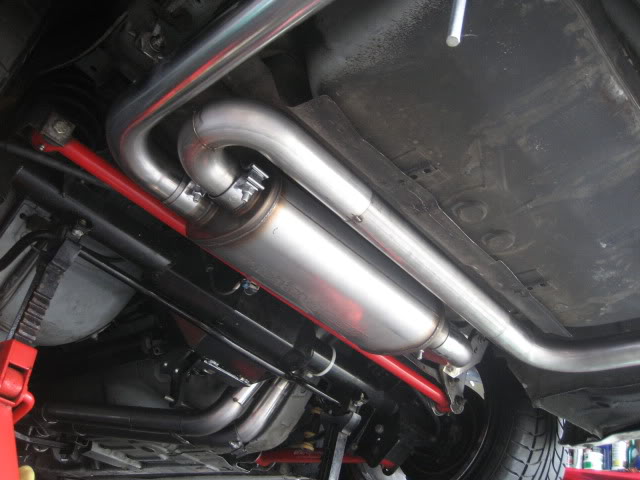

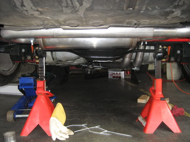

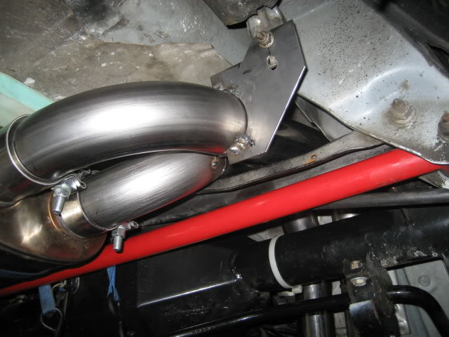

Below are current pics of the my current setup:

Like I said great job Bill, I may have to look into something like that later, lol
Old Jul 5, 2009 | 01:20 PM
BlackBird97's Avatar
Joined: Sep 2003
Posts: 451
From: Chicago IL
Wow, that looks incredible. Excellent work!
