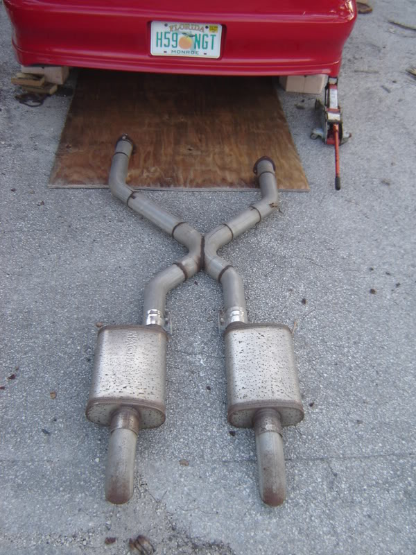

get better mufflers.
my magnaflow 4x9s do a GREAT job quieting my cam only LS1.
the setup:
xpipe with no mufflers:
same day with mufflers installed, never moved the camera:
