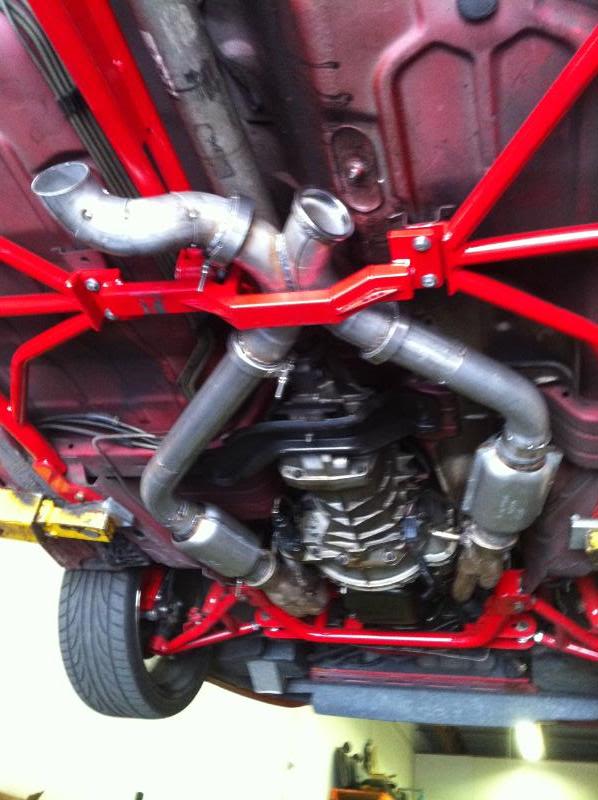

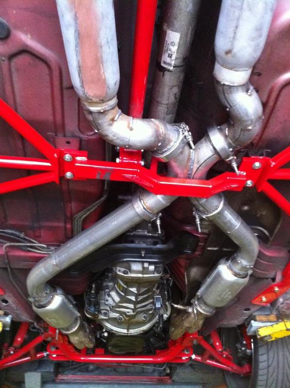

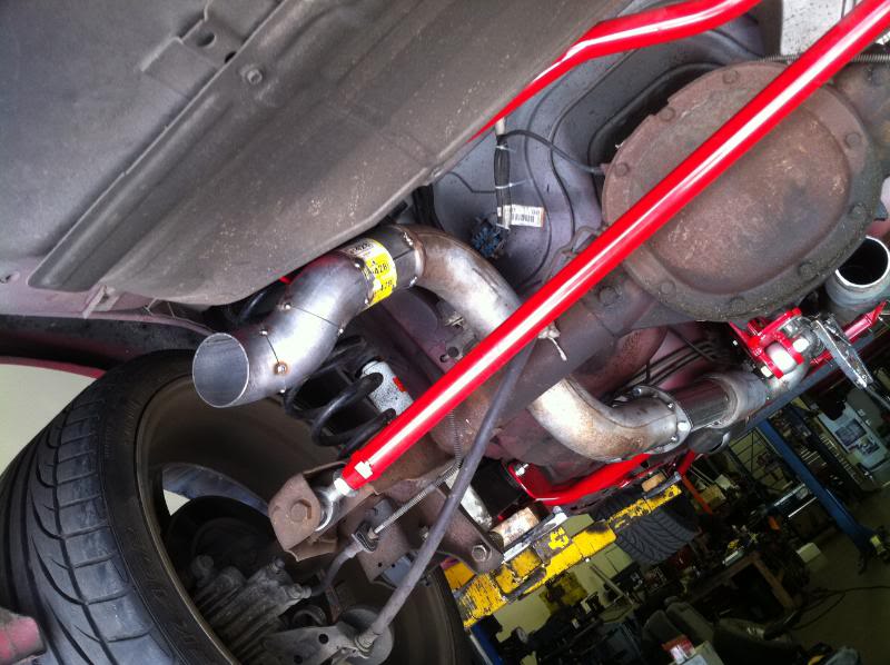

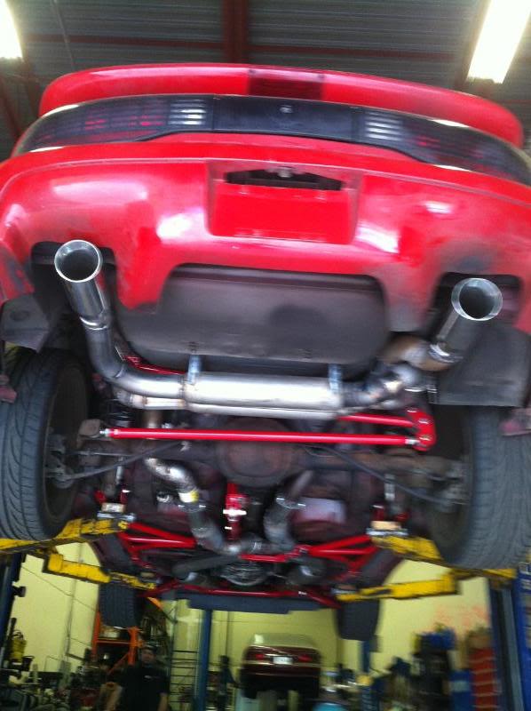

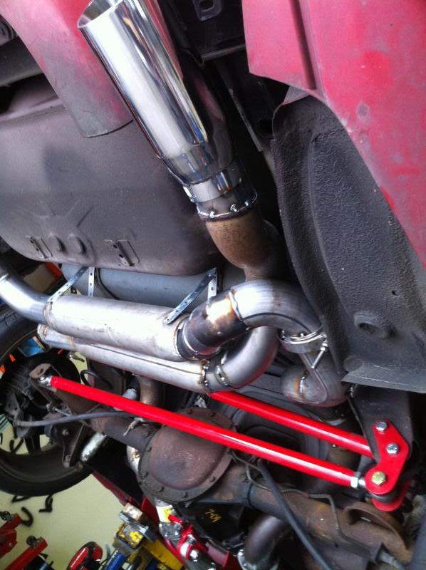

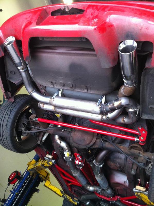

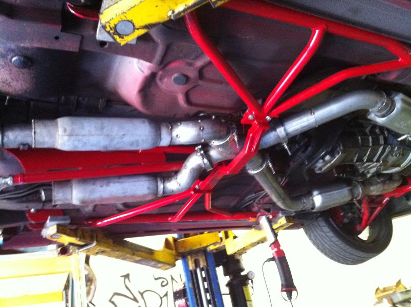

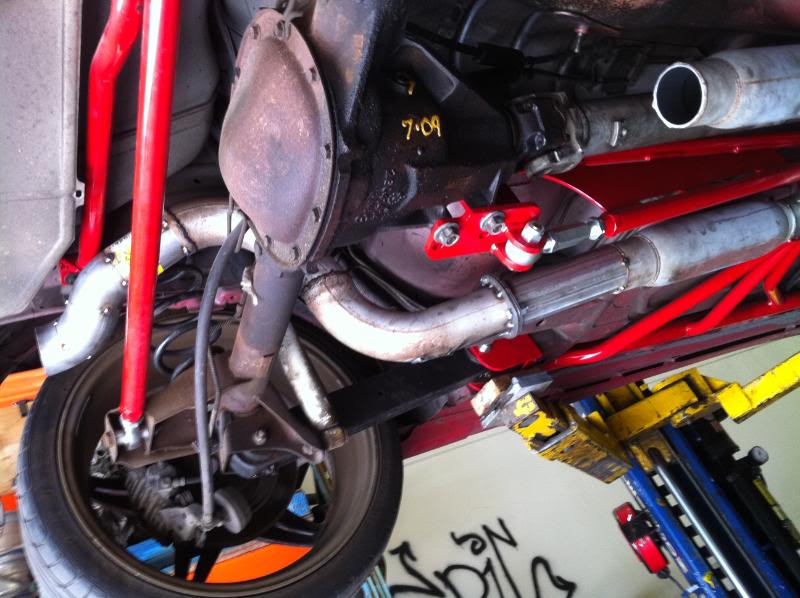

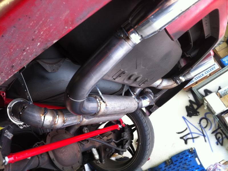

just made some changes to my exhaust setup and thought id share. im running flp long tubes, was previously true duals just dumped before axle with 4 in line resonators ( 2 on each side ) was super loud and over time annoying.
having installed umi performance sub frames and a host of other suspension it would no longer clear so we took the opportunity to revamp the whole setup and include an x pipe and have it rear exit. so far it just barely touches going over large speed bumps and it touches the lower panhard bar on very hard bumps, but for true dual 3" rear exit im more then happy with the clearance.
for sound everyone seems to remark on how quiet it is for what it is, we added 2 3" cats for emmisions testing purposes, later to be replaced with bullet mufflers for better flow when the new motor and blower goes in.
whats not pictured is we added flex pipes before the x pipe and have noticed a lot less rattles, and x pipe back the system is painted black, ill probably thermal coat it later this winter when the car is off the road.
enjoy the pics!
