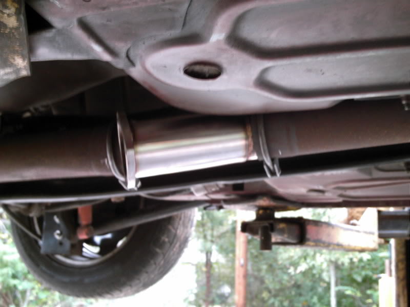

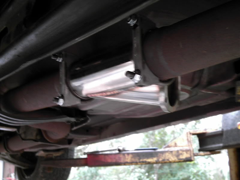

in my video you can see it. Mines mounted right up and under the passenger rear seat
I'll post some pix of installName:  Picture009.jpg
