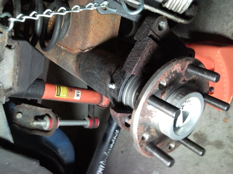

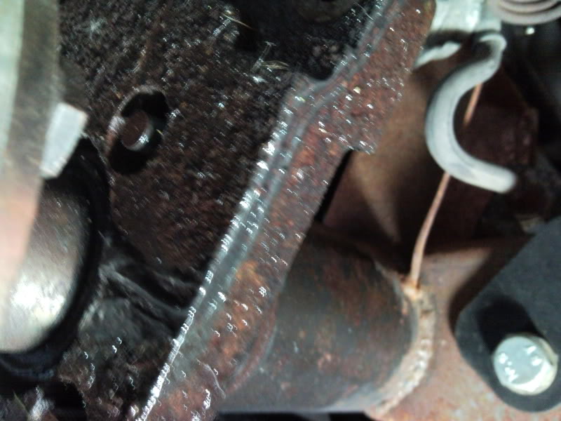

So I noticed a couple small puddles starting to form under the ends of my S60. I've only had the thing little over a year and only driven it about 2500-3000miles. I pulled my tire and brake off to find that there is a grease point on the end of the axle tube. I had a local guy install this thing and he failed to mention this was there. Nothing in the Strange paperwork said anything about this either. Can I just put some grease in here and hope it fixes the leak or would it have nothing to do with the leak?
Grease Nipple.

Leaky leaky

Don't know about the leak but I put a couple of pumps into mine every year but mine only gets a hundred or so miles a year a 1/4 mile at a time.

haha I forgot about my grease zerks too. YIKES! I should put a couple pumps in there this spring when I dig her out.
As far as the leak, that is a seal. Grease will not stop that. You will have to replace the seal if you want to dry up that leak. Sorry to be the bearer of bad news buddy.
