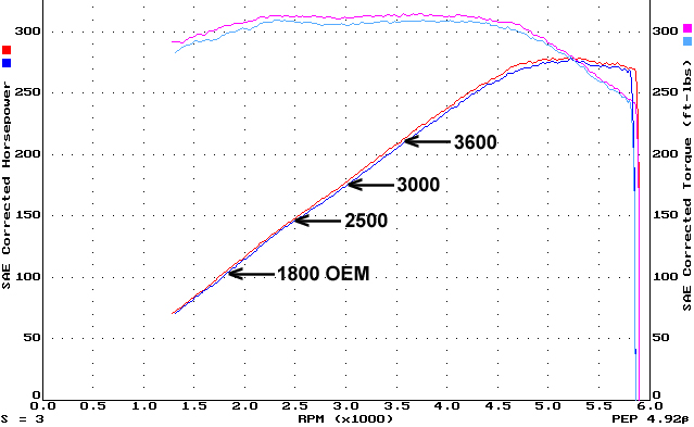

3.23s' to 3.73s' is a 15% increase in torque to the pavement.
Along with a stall change
be a perceived 'feel like' 150hp SOTP gain.
