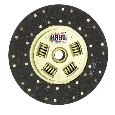

Post a pic of the disk from the side showing the facing edges if you want.

ok heres a pic...http://static.summitracing.com/globa...y-40-221_w.jpg

Wrong angle in the pic. The side of the disk (thin section).

yep def. a macel thing between here's its info http://www.haysclutches.com/ProductD...minselection=0

I will nearly bet the farm you have a marcel disk and it is out of spec as stated above. Again the pull clutch release window is stupid tight and things must be very precise. Get out of that window and you get disk drag with the pedal pushed all the way down causing your problem.
That disk would work perfect for a pull clutch. But as you found out, not a pull type.
