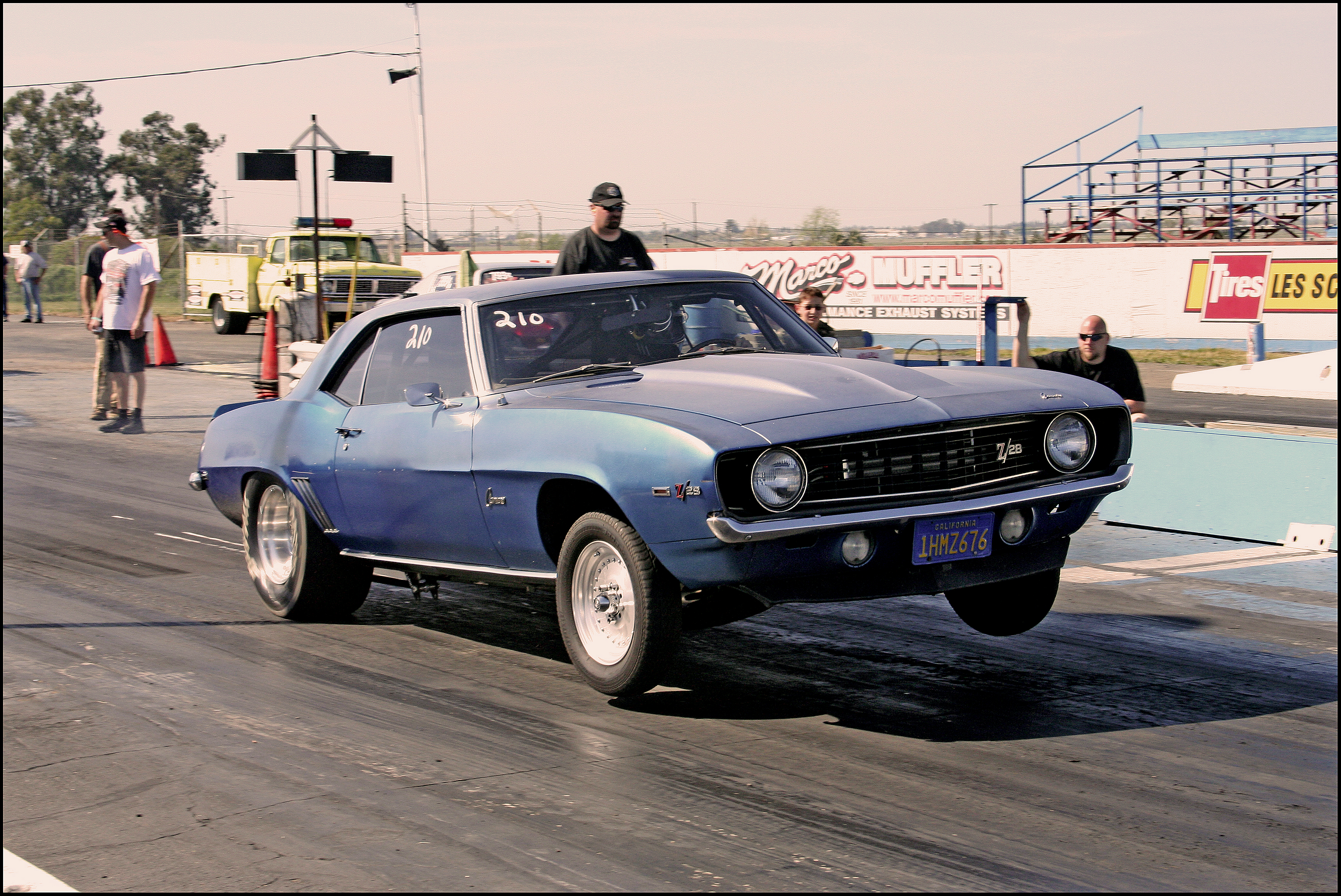

With an 8 point cage your car should not gain that much weight. I put a 10 point in my car. At the same time I replaced the front seats with aluminum Kirkey seats and removed the rear seat. Net weight increase was 50 pounds.
Loosen up the front suspension first. Remove the front swaybar if it has one and try to maximize front suspension travel. Cut the bump stop in half. Then add Caltracs with split monos in the rear.
