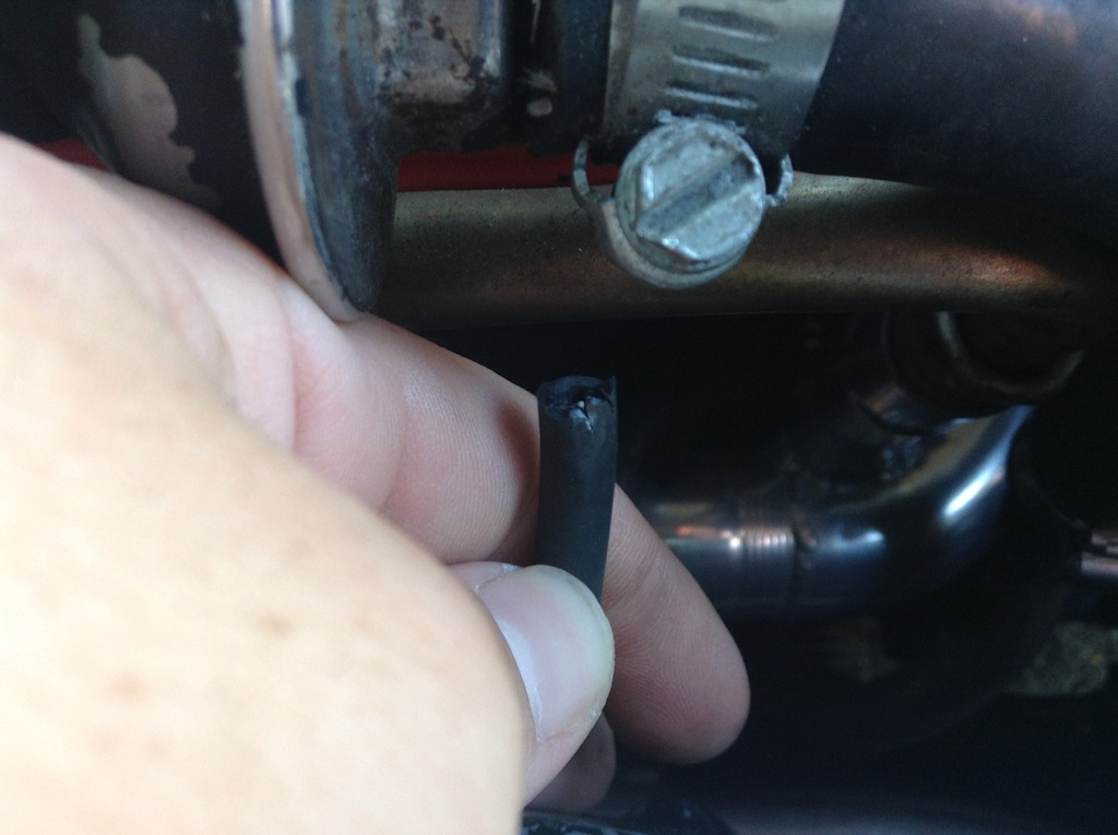

Ok so I checked the spark plug wires today and found out one of if not THE problem(s) with my misfire.
My wire on the right side Of my motor fell off into my hand when I tried to removed the boot from the plug.
I added a picture showing where the wire was dry rotted and arching to the headers. You can see where the heat was radiating through the wire. Its charred from the inside out.
Attachment 2989
I'm looking at these wires as replacements. Are these good? Or do you recommend something else?
MSD Ignition Super Conductor Plug Wire Set 32149: Advance Auto Parts
MDZ28 Sep 24, 2015 09:15 AM
Re: tuning software for 95 camaro?
So I replaced the spark plug wires and they all had numerous dry rotted spots. They also had chunks taken out in various places throughout the wire (like mice had been chewing on them or something).
Anyways I started the car up and it runs like a champ now. I finally have the feeling I remember with the old motor but its a lot faster :)
Glad to finally have a working car again. Thanks to everyone who helped out over the numerous threads.
