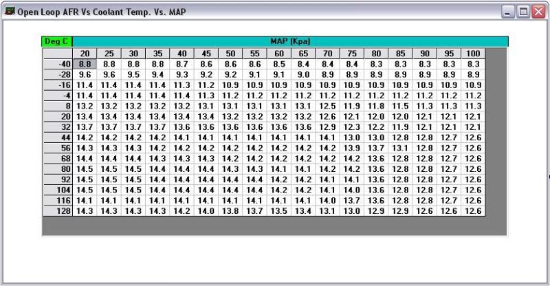

Leaning out OL to avoid smell
What is the safest I can lean out my OL tables? On startup the exhaust smell is pretty strong and the wideband reads an afr in the 10s.
I'm moving into a new private garage and don't want the startup exhaust smell to be a problem for the tenants above. I figure if I lean out the OL tables it would smell less.
Do you think if i make the lowest OL afr target 12.5 the car would still start without problems even in cold weather?

I'll post up my open loop table later tonight. It worked for me every morning down to at least -10F. I spent a lot of time calibrating my maf though and what i commanded was always what I got so your results may vary.
Theory here being that if it starts to die, map will drop off and it will richen up and catch itself. Never had any trouble with it. Its leaner than stock but still conservative if you have a decent comp ratio.
thanks bro. long time no speak. just got my car back. i'll drop you an email to catch up on things.
