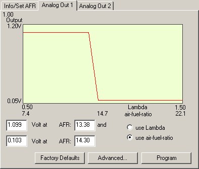

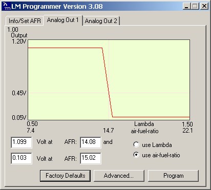

Sure. First I need to correct my typo above. I meant to say LC-1 but typed LM-1.
Basically these allow you to replace your stock narrow band O2s with the widebands. They will output an analog "narrow band simulation" to the PCM. But the output is programmable. This is the factory default of the first analog output:
450 MV = 14.7 AFR, a very narrow step-like function close to what narrow bands output, your PCM shouldn't know the difference between this and the stock O2. It should run the same. But you can put any numbers you want in there. Simply subtract .7 from both AFR boundaries like so:
Now 450 MV = 14.0 AFR. Your computer won't know the difference, but you'll be running richer in closed loop because your computer will force it to run averaging 450 MV, and it will correct to that constantly.
They have their Manual online. They also have a message board with some good info--HERE is a thread that talks about doing it the other way for better mileage.

Thanks this is just what I was looking for. I still might try the resistor trick.
