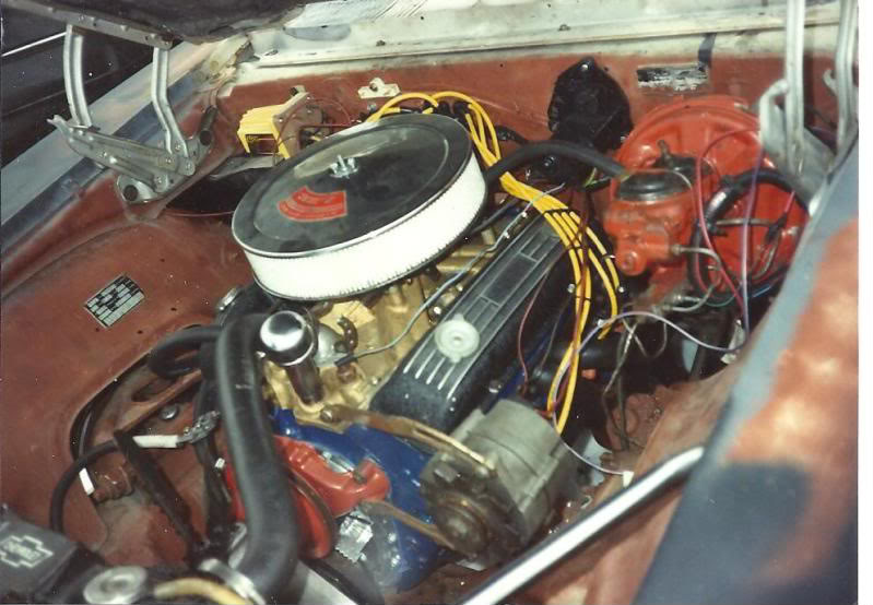

This is the engine I started out with. I built it in my Dorm Room in Wiesbaden Germany, with parts ordered from PAW.

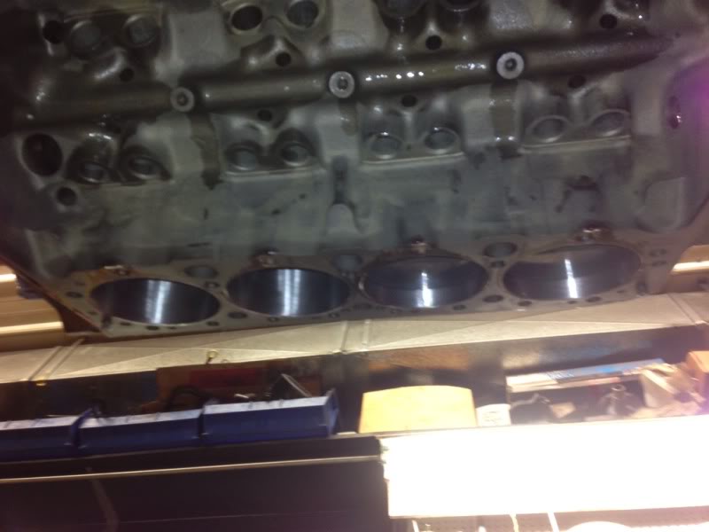

We fire cleaned, and media blasted the block to remove any rust and dirt.
It was then line honed through the cam and crank bearings to be sure it was straight. The cylinders were bored, 4.030 through Torque plates, again to make sure it would all be true with the heads installed.

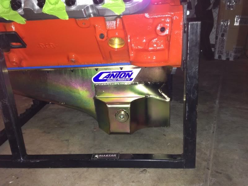

The oil pan is a Canton with kick outs on both sides and doors to keep the oil where it is supposed to be.
