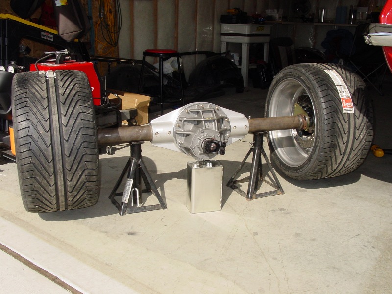

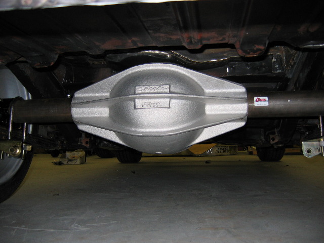

Raab, your description of my Currie is dead on. LOL
My Currie 9" rear end

I kicked around the idea of a Fab 9, but since I didn't know 100% where the perches were going, I decided against that and went with a housing that allowed me to use the adjustable perches.
