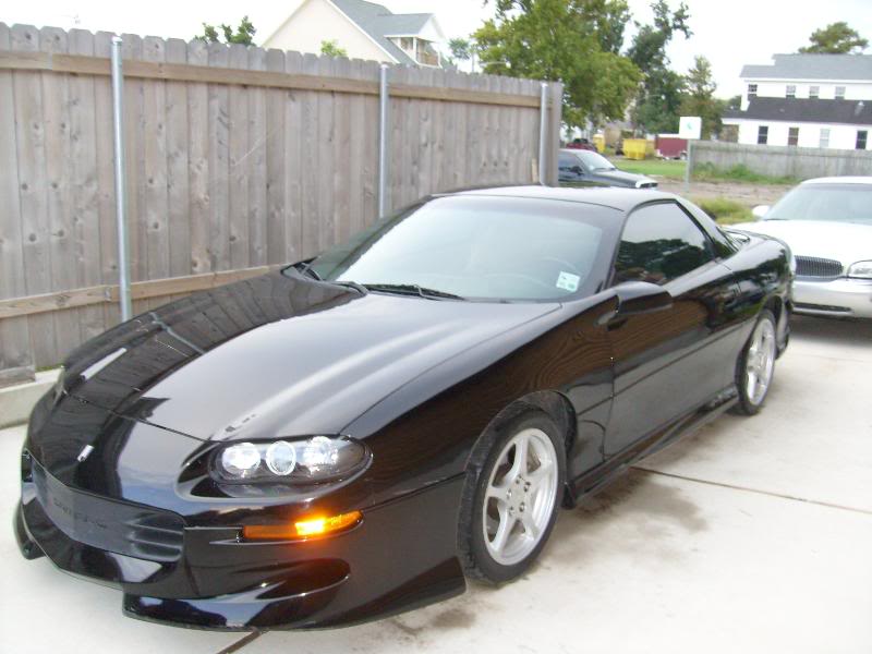

1998 v6 Body – 2000 LS1 motor swap, t56 6 speed.
7x,xxx miles on the motor. 6x,xxx miles on the body.
Less than 1000 miles (prob less than 500) on the rebuilt.
• Rebuilt top end, valves, etc
• LS6 intake manifold
• Ported throttle-body
• Clear air intake lid
• TR224/224-112 lsa cam
• HALS QA1 12-way adjustable suspension
• Strange 12-bolt rear-end with 4.10 gearing
• Rebuilt t56 (to stock) 6 speed transmission, Skip-shift installed
• 3” Hooker LT Headers, Hooker ORYP, Hooker cat-back exhaust
• Y2K Corvette wheels, 255/35/17 front, 275/30/18 rear
• Lou’s short shift shifter
• SPEC stage 3+ clutch, new fly-wheel
The motor misfires from 1500 to 3500 rpm. It ran perfectly for about a year before the misfire started.
I may be missing a few mods on the list, but that is the jist of it.
Thanks,
Cory
