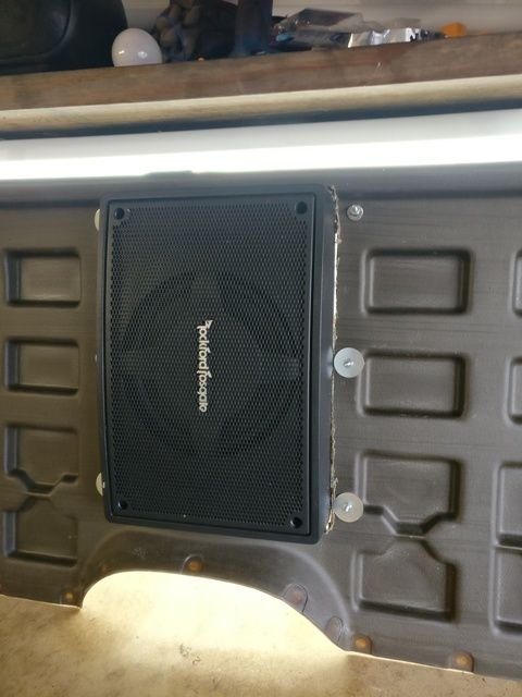

I placed the subwoofer in the seat back, drilled holes for the bolts that will hold the subwoofer to the seat and mounted the subwoofer assembly to the seat back. I used fender washers in order to spread the support over a wider area.

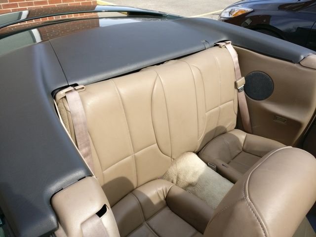

The completed project back in the car. There is no indication there is a subwoofer mounted but I get great subwoofer bass. It looks original and my tonneau cover fits as it should. I also have full use of my limited trunk space.
I'm very satisfied with the end results.
