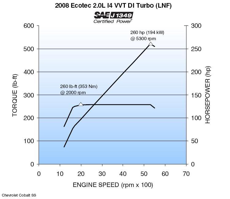

Modern turbo 4s - like the LNF in the Kappa and Cobalt SS - are a far cry from the laggy, cranky, peaky monsters from the 80s. In fact, they feel like little V8s. The LNF, in fact, has a flatter torque curve than virtually any NA engine:
Combine that with a 6-speed auto and properly-designed torque converter, and it'd make a great engine for most any vehicle that currently uses a large V6 or small V8.

One should be careful when relying soley on the dyno graph for determining an engine's characteristics. Remember dynos are taken at full throttle, which plays right into a turbo motor's strengths and shows them in the best possible light. Catch one flat-footed at 1800 rpm however and see how well it compares to a 4.8 V8. Even though engineers have made great progress in the areas of throttle response and turbo lag, an FI engine still can't compete with NA. Heck, most engines period don't compare well to an LSx for part-throttle response.
