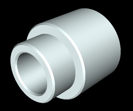

It has been brought to my attention that you can no longer get the 1" by .250 wall tubing from which to make the spacers from Aircraft Spruce unless you want to buy 6 feet of the stuff. There goes that plan for making cheap spacers.....
I've looked into getting some stepped aluminum spacers machined like this:
http://www.jonaadland.com/NewPics3/SpacerLCA.JPG
Depending upon how many people were interested, they'd go for around $30 for a set of 8 for the LCA's. Would you guys be interested in having me do this?
