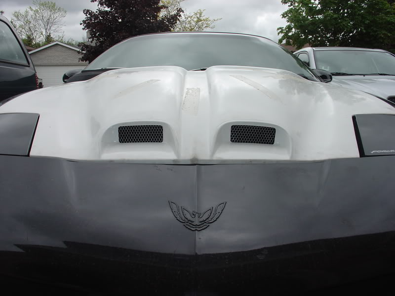

Somebody else must have purchased this hood.
Here's a pic of how the front of the hood lines up.

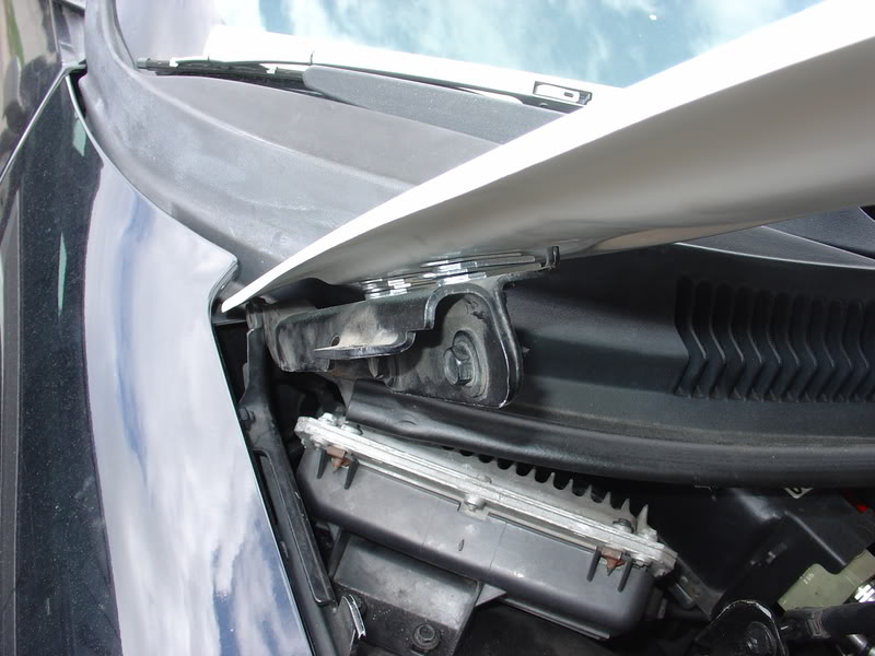

And here's a pic of how much I have to shim/raise the hood to get it to line up at the back.

Old Jun 8, 2008 | 11:52 AM
shock6906's Avatar
Joined: Mar 2004
Posts: 3,577
From: Sandy VJJville
Boy, that fits like dog s**t. I'd be pretty pissed if my hood was like that when I bought it.

Old Jun 8, 2008 | 06:11 PM
LT4 Formula's Avatar
Joined: Jul 2007
Posts: 39
I've seen some pretty bad fiberglass hoods and I haven't written this one off yet. There's a couple of things I can do to make it fit better. I can slot the holes in the hinge brackets to get rid of the shims that I'm using temporarily. As for the front not lining up, looking at the picture Suncoast has on their website of the hood, it looks like they've shimmed up the middle of the nose to match the hood.
Adjusting the center point of the hood and making the gaps on both side match is easy. It does follow the body lines nicely down the fenders when raised to the right height.
I just don't want to start modifying the hinges or changing the body lines if the hood was molded improperly to begin with. As soon as I start modifying the hinge brackets, it would be a royal pain to re-align the factory hood if I had to.
Hopefully someone will chime in that has fit one of these hoods before.
