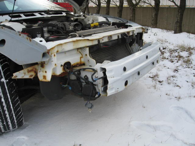

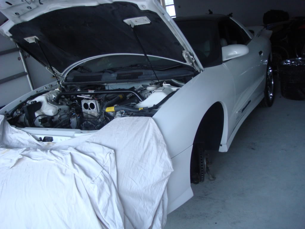

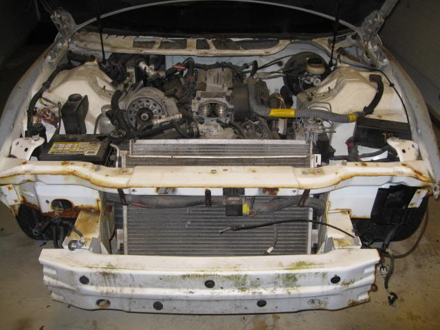

Me and my dad are working on this project, This is a 25th Trans am only 2000 made. This Car came to Iceland around 2004. He stood out site to late 2008. then we started to work on him
Here are some picture

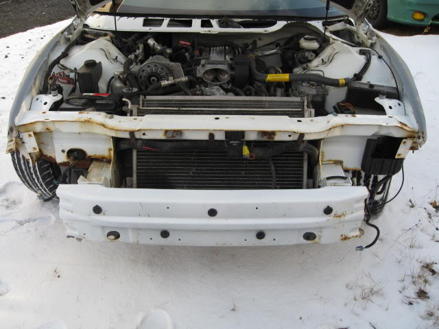

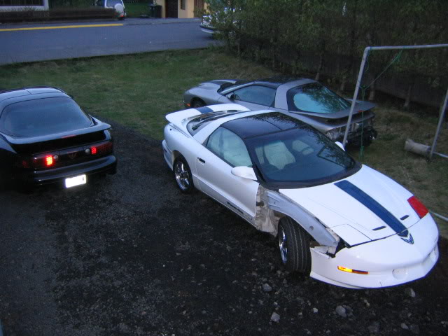

He came in this condition

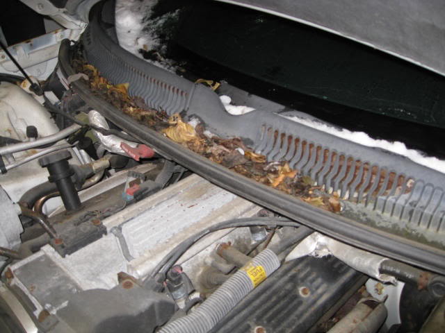

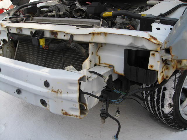

And after 4 stupid years of standing outsite

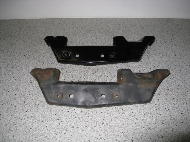

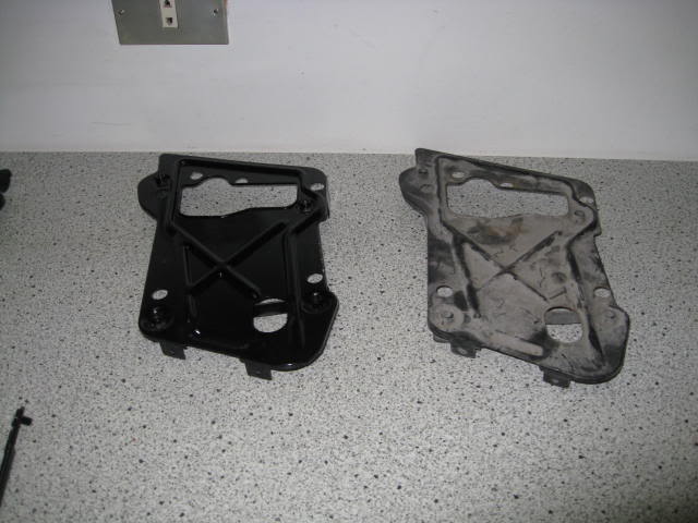

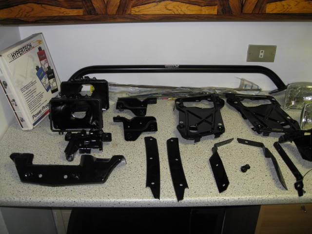

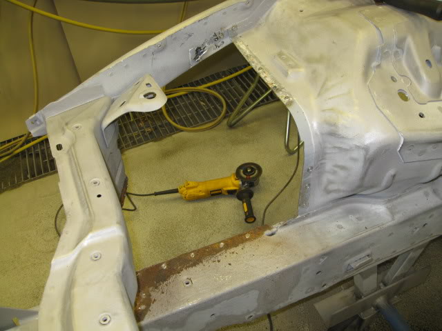

And then we took al rusted parts, sandblasted and painted black again

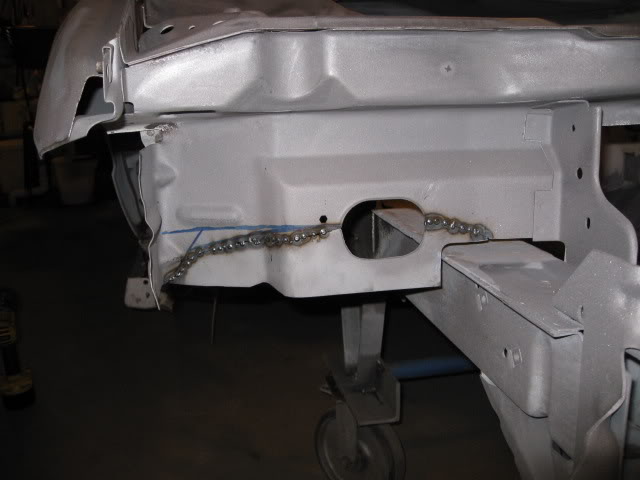

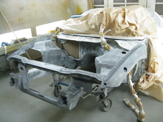

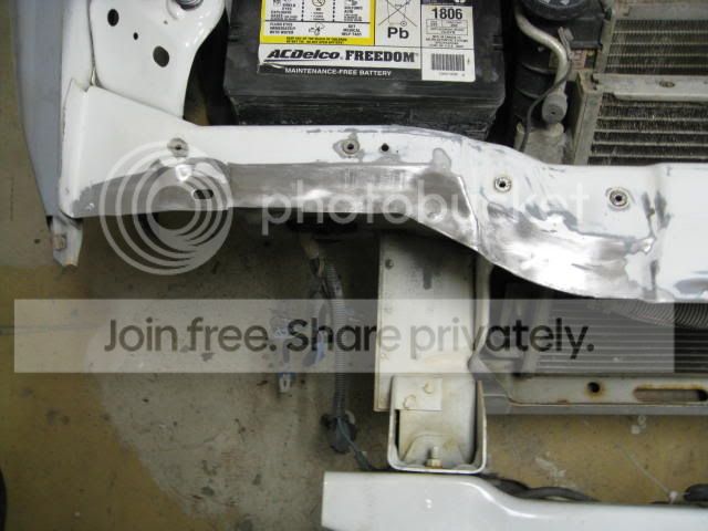

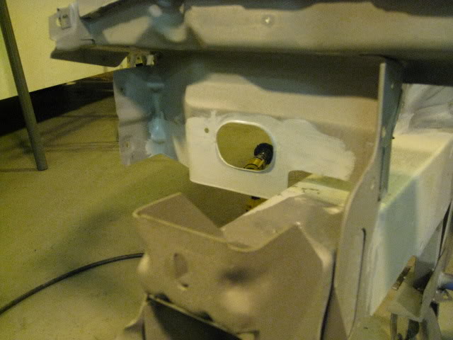

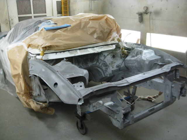

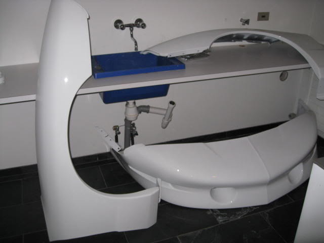

Sandblasted front of the car and painted

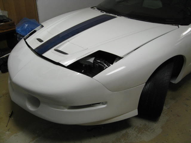

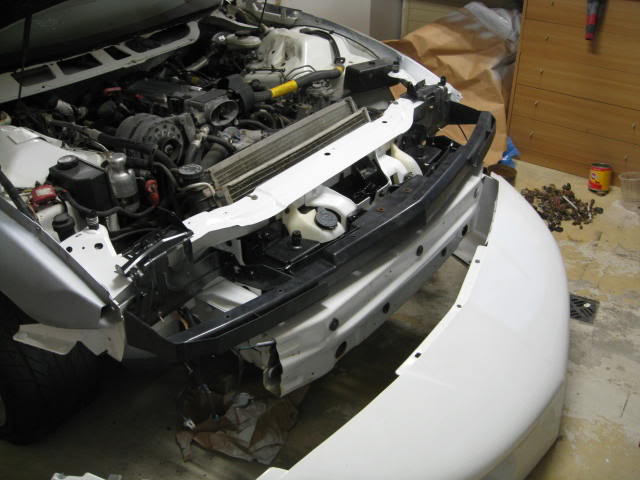

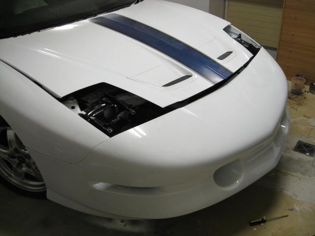

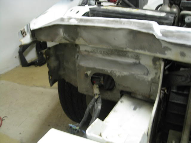

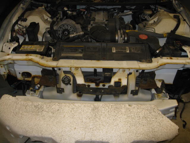

New Front bumper and fenders

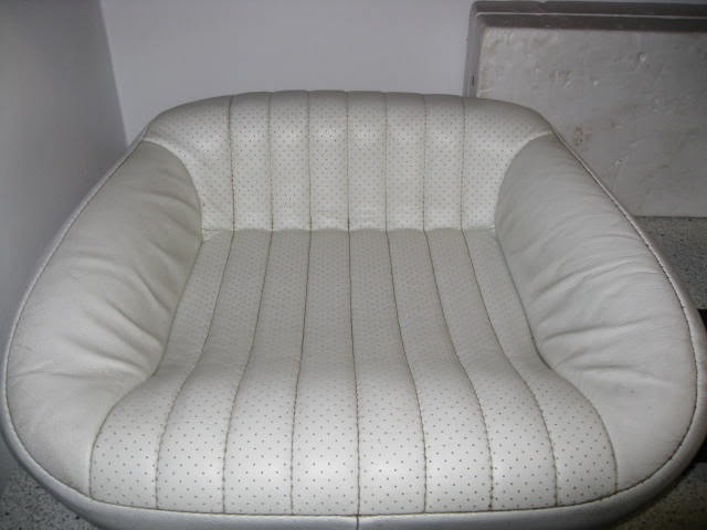

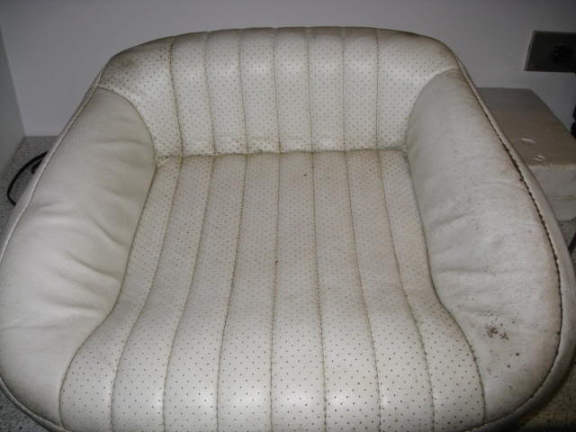

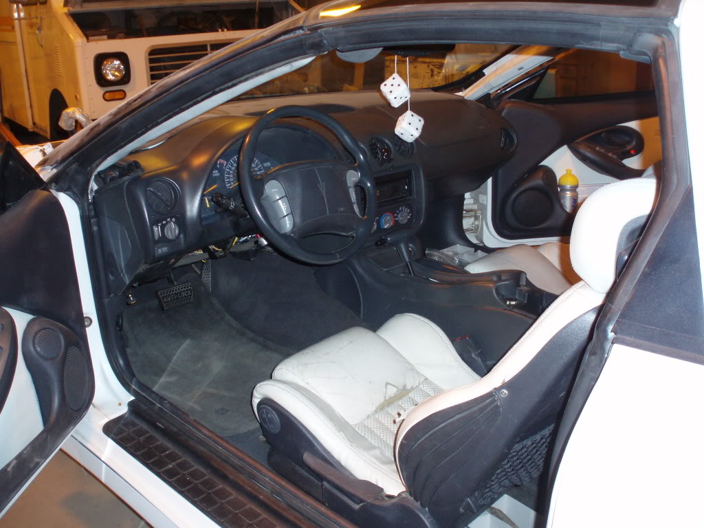

After 4 years standing outsite the seats was started to mold

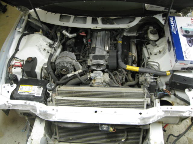

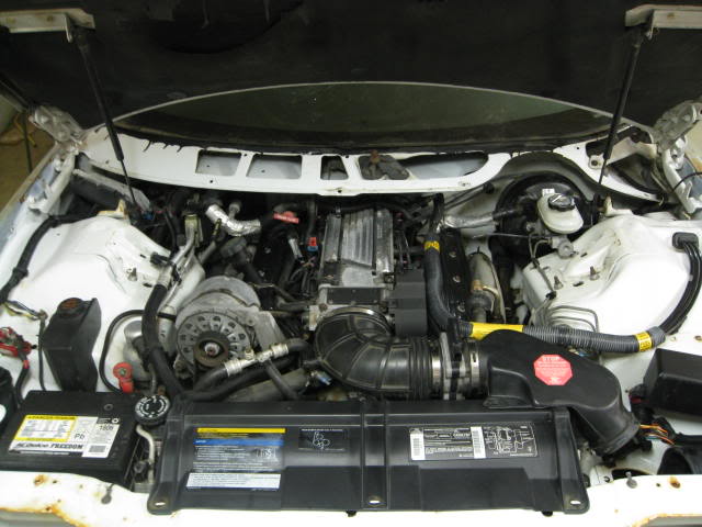

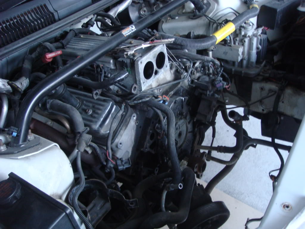

Engine bay
Before
After

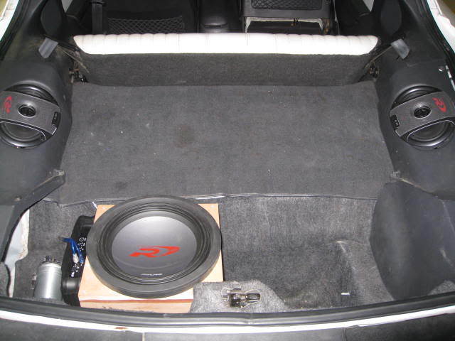

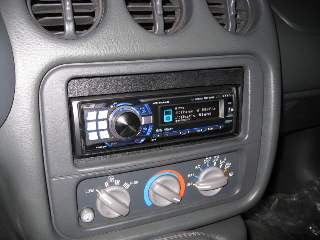

I worked on the stereo, I got 6 speakers and 1 subwoofer and amplifier All Alpine Type R

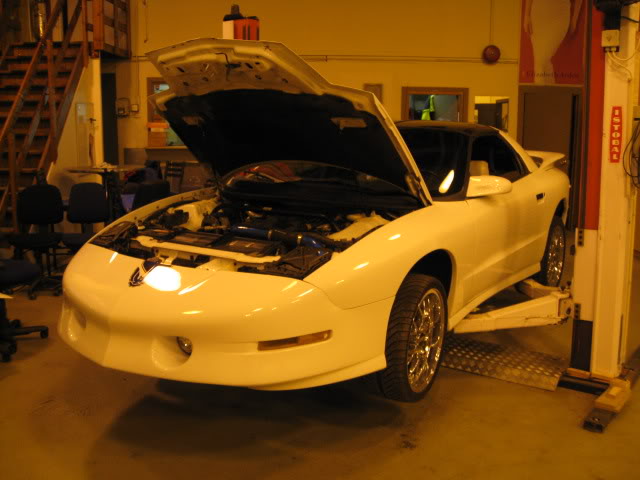

Trans am ready

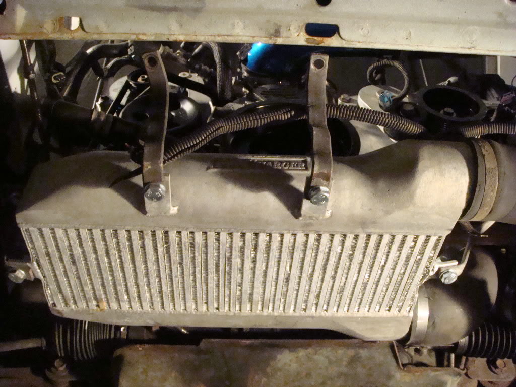

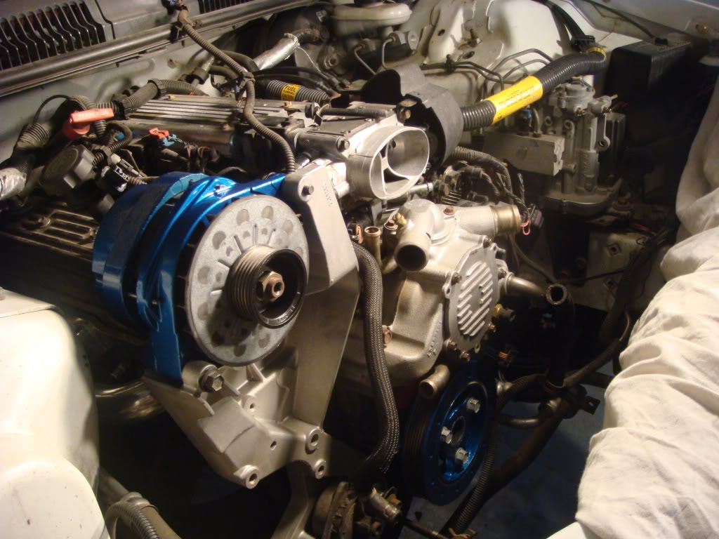

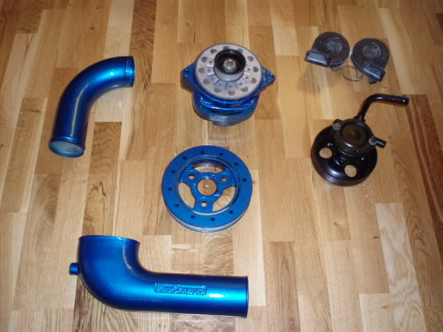

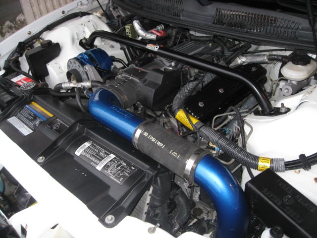

Procharger P-1SC system

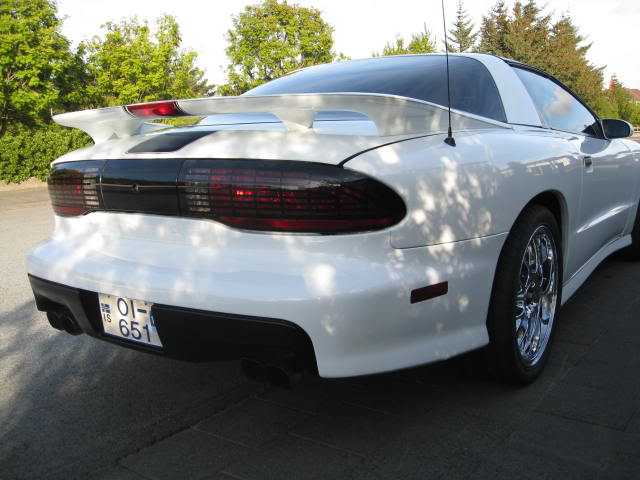

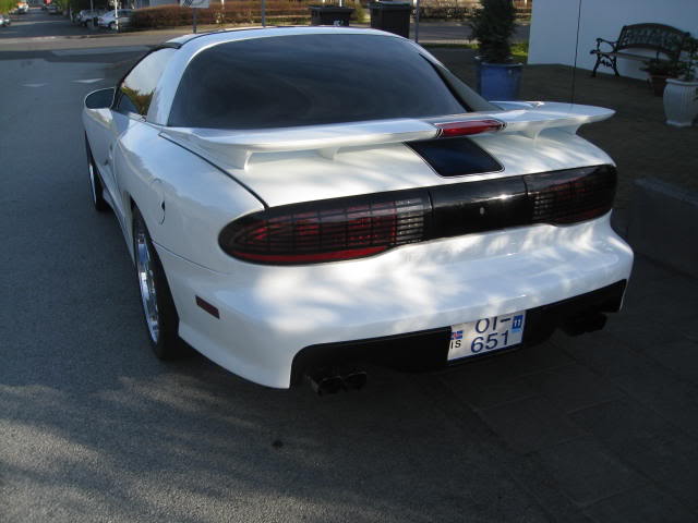

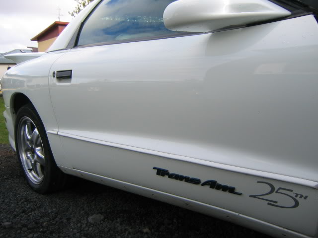

After the car was ready for the street i took it and painted rear bumper with ceta look, both doors and side spoilers and tinted the side windows

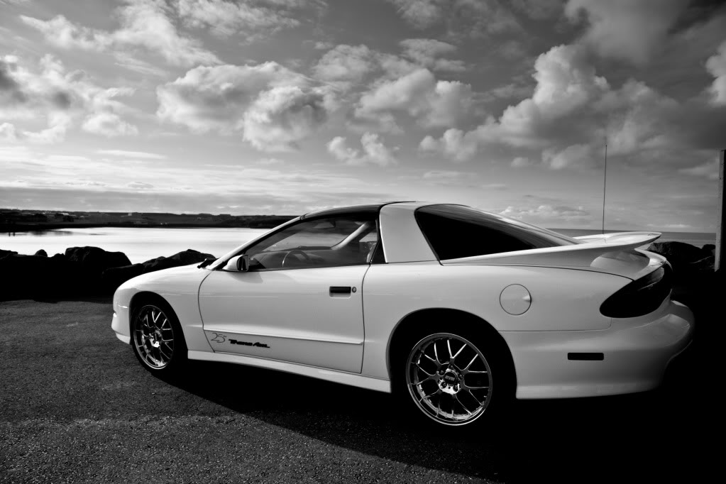

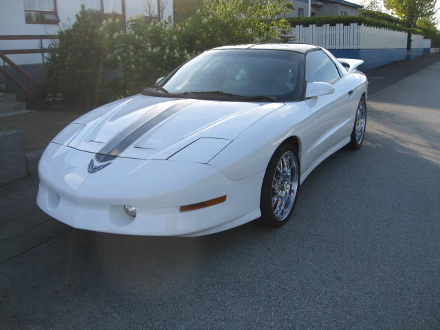

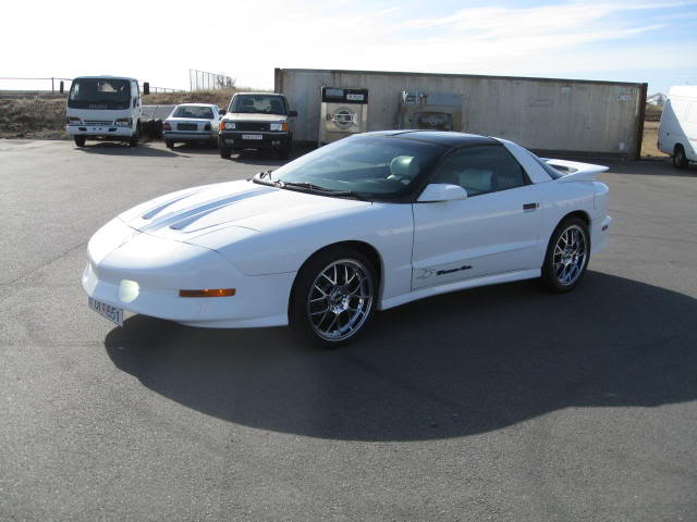

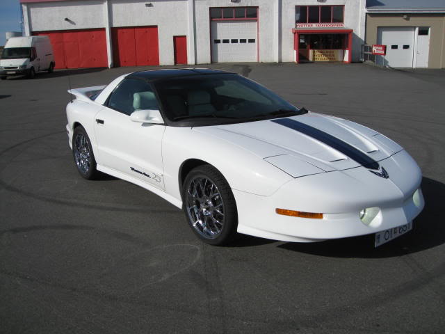

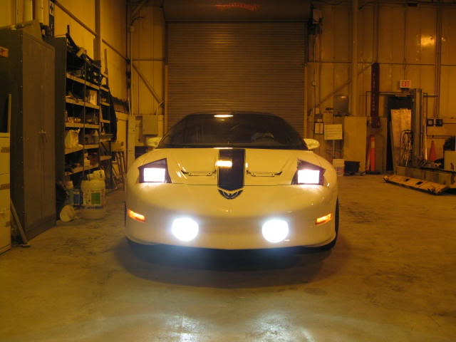

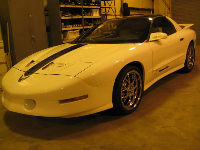

Finished
Things that i did
P-1SC system
Pace setter headers
A/C delete
Taylor spark plug wires
MSD rotor kit
Lunati timing chain

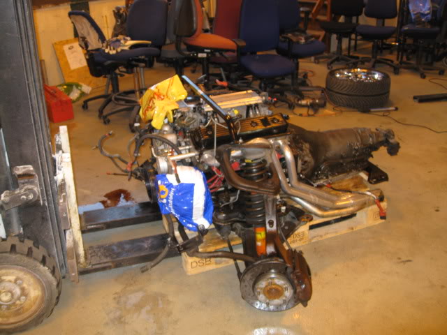

I was really happy with the car, i went on the track and took 5 runs after the 5th run the car was leaking oil, smoke coming up with valve covers, I blew upp the engine. My MOM told me if you let the blower on it you will blow upp the engine, She was wright, but i knew it to. Now i got a good reason to buy a new engine

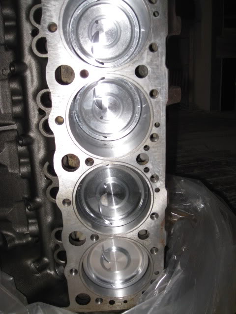

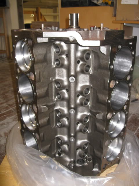

I bought LT1-4 396 forged short block from CNC-motorsport

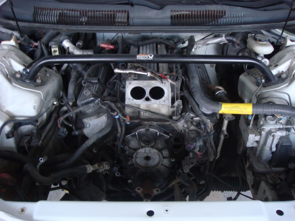

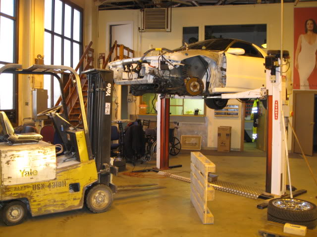

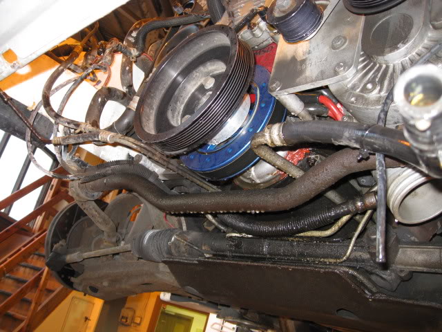

Old engine out

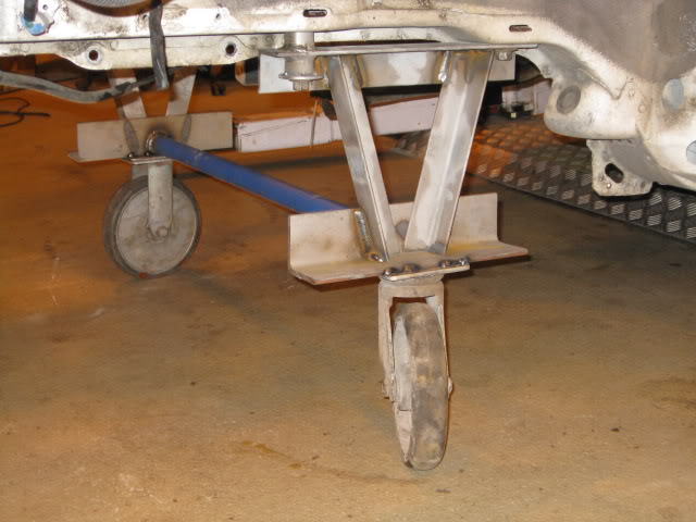

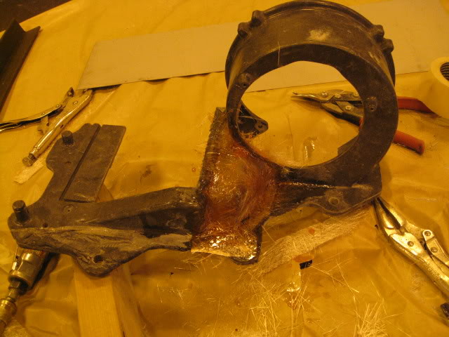

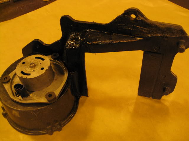

We built this braket

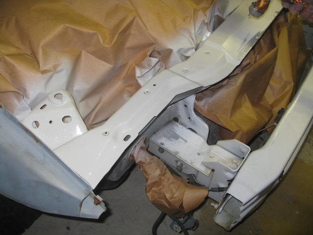

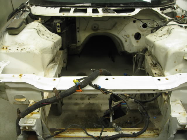

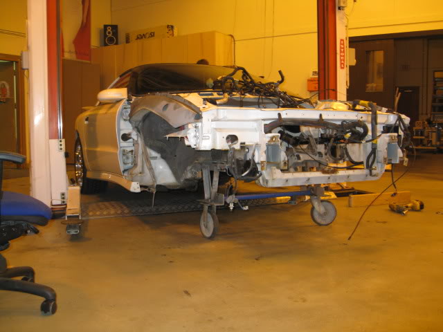

Engine bay

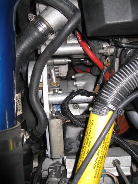

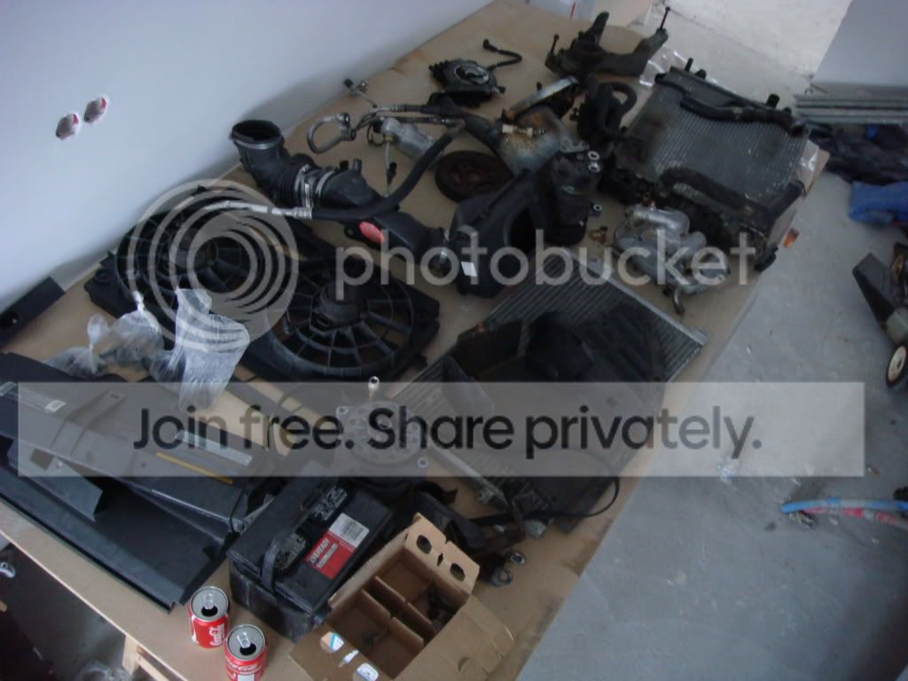

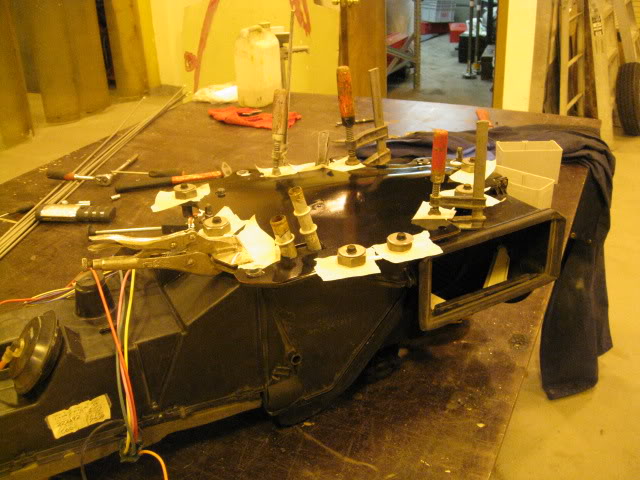

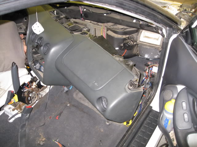

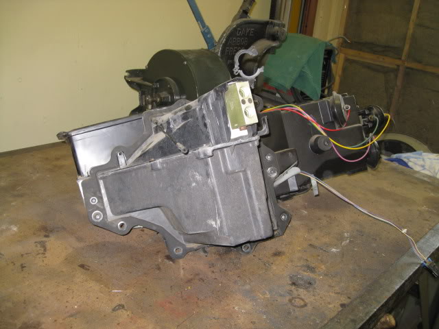

We took the dash out to get A/C out
Old Feb 6, 2011 | 08:55 AM
Blown-396's Avatar
Joined: Jan 2011
Posts: 29
Re: Pontiac Trans am 25th anniversary // Blown 396

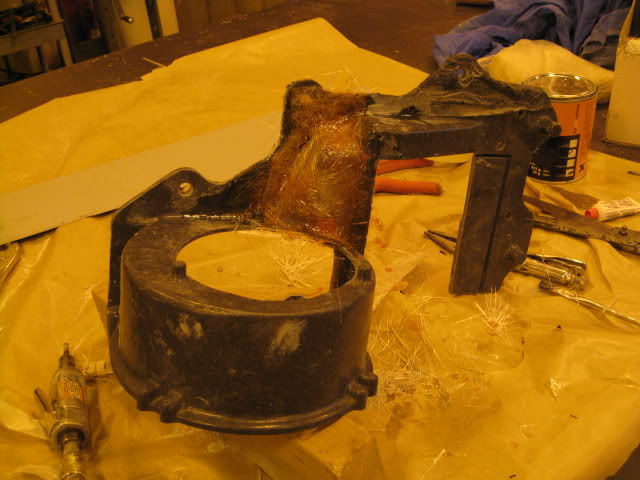

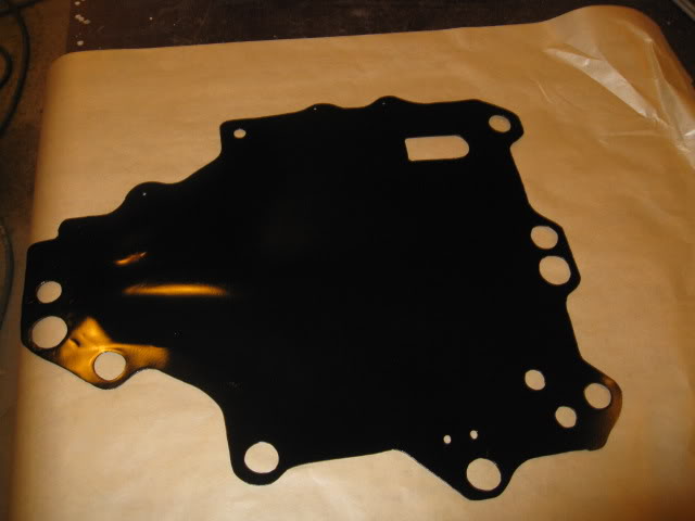

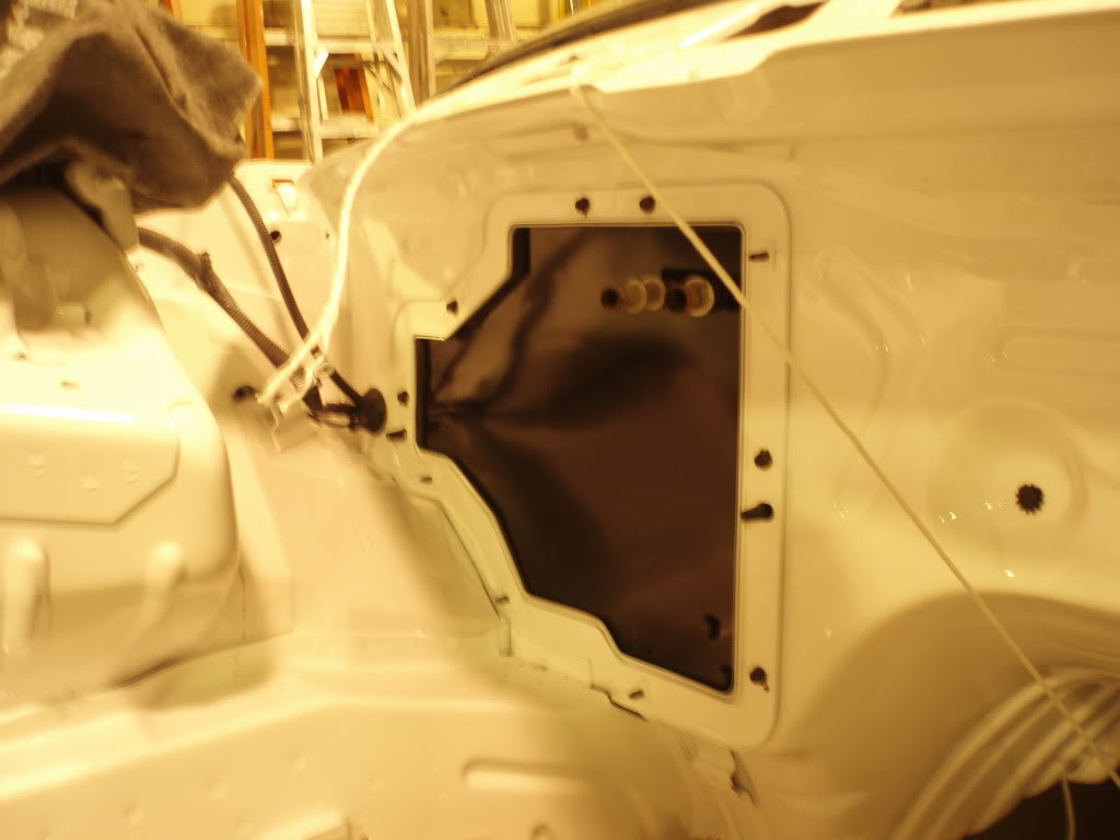

We made A/C delete plate

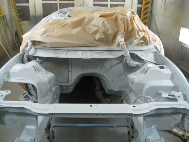

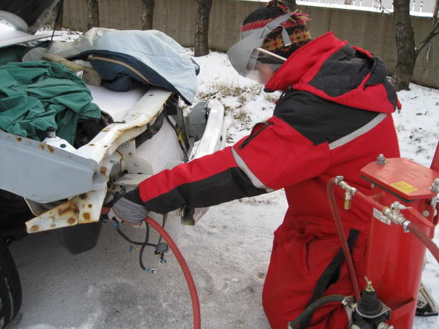

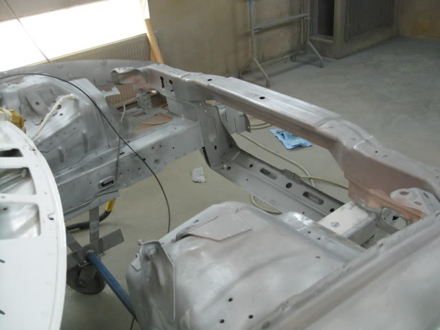

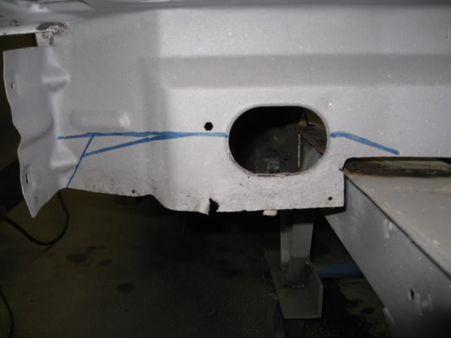

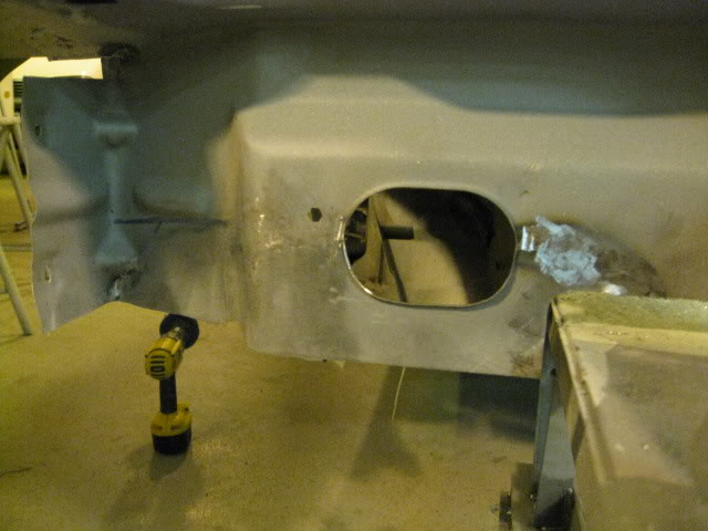

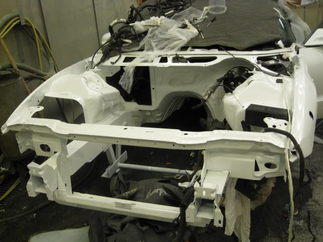

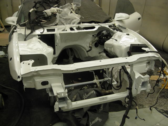

Sandblasted the engine bay

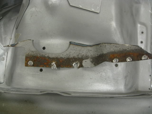

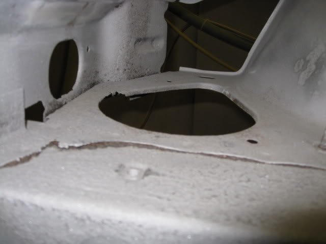

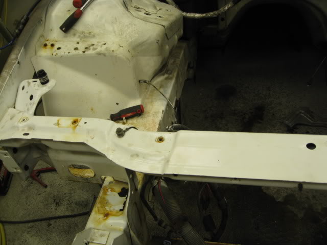

To much rust
RUST

A/C delete plate

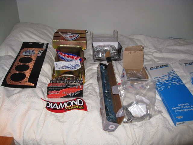

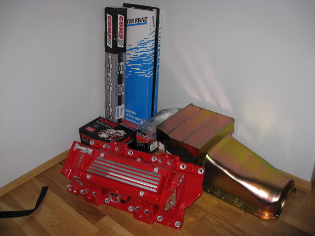

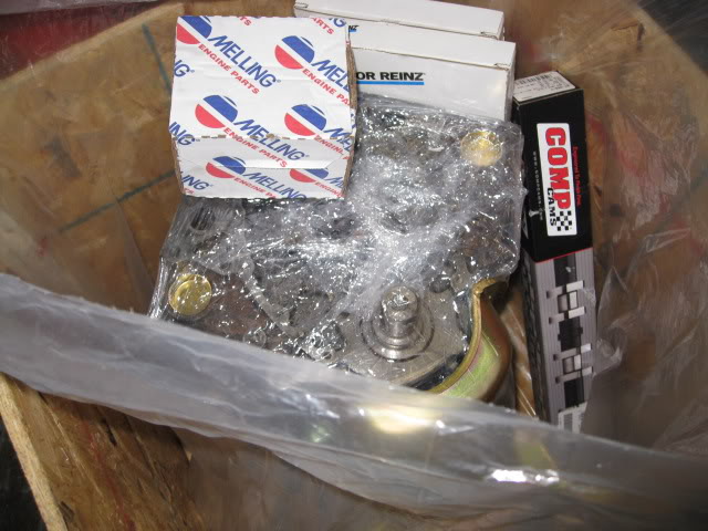

Now the car is ready for new engine
New package
CSR waterpump
Cloeys double roller timing chain
ARP heddstuds
Coan Racing 3500-4000stall convertor
ATI Super damper
ATI Supercharger damper hub
TCI flexplate
Prothane Motor and trans mount
MSD Coil
LT4 edelbrock intake mainfold
Engine
LT4 396
- 6.000 Eagle ESP 3-D H-beam
- Diamond piston 8.0:1
- Eagle 4340 steel 252/262 630 lift 114 lsa
- O-ring block
- Splayed caps
- Kevko Drag/street oil pan
- Melling M55HV
- Lunati sollid roller lifters
This is good for now, i will update when i get new parts
