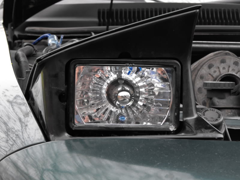

Did the conversion to my 94 Formula with the h4 conversion housings and a 6000k h4 kit. Work like a charm and are an absolute must as the stock lights are complete garbage and as you said you cant see anything. Just make sure your hid kit comes with the fuse and relay harness so your not burning out your ballasts.
Just make sure you have your lights pointed down as they are very bright in these housings. This is a pic of the first night i had them in and as you can see my lights are pointed right up and not even on the ground but that was an easy fix.
where did you get your kit from? looks great by the way
Thanks for the compliments!
As for the housings i got them at my local performance shop and there made by Eurolite as you can see by the boxes in the pics. I think the housings were $60 and the HID kit was $120 and prices are Canadian. When you get your kit it may or may not come with a direct plug and play harness as the stock harness has the 3 prong connector opposed the 2 wires from the h4 kit. You can get a harness or you can just splice into the stock harness and its hardwired in and still keep the 3 prong plug if you want to go back to stock like i did. My kit was made to run a relay and fuse as the stock wiring cannot handle the power needed by the ballasts so this acts as safety factor as you will notice sometimes that some cars running them at night only have on light on or it flickers and this is why. Run it from the battery into the harness and your set. The housings were a little tricky as they dont sit flush in the place cause there a tad smaller. I used a peice of cardboard to help make it sit flush in place. Thats really all you have to worry about and the pay off is well worth it on your first drive at night
