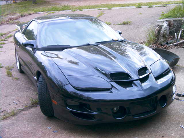

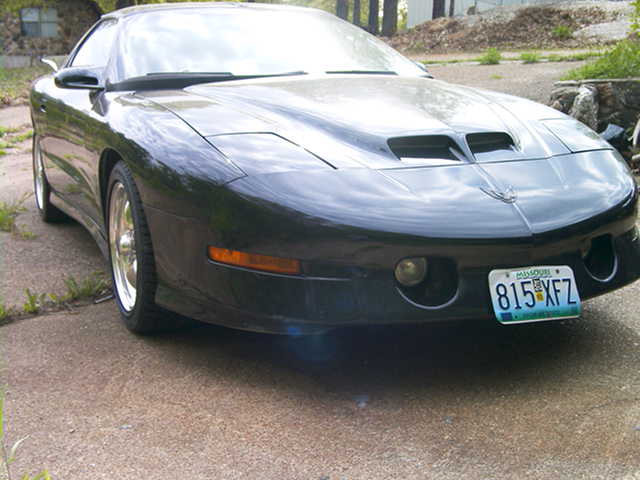

Just did another front clip conversion; 96 Ram Air to 2001 Ram Air....
Old Apr 27, 2005 | 09:06 PM
Ryan94ZA4's Avatar
Joined: Mar 2002
Posts: 595
From: Missouri
Took me about 4 hours. I like the new clip much better....
http://www.aldersgarage.20m.com/images/RIMG0136.JPG
http://www.aldersgarage.20m.com/images/RIMG0143.JPG

No doubt man, that looks 100% better....I'm thinken about slappen a 99 front clip on my 94 camaro. Is it fairly easy to do?

i like the 93-97 front end when it has a ram air hood to compliment it. The 98-up front end looks much better b/c it has a lot more detail to it and isn't plain like the earlier models. nice upgrade.
btw, why did you do the conversion besides the obvious appearance difference? most people do it b/c they were in an accident.

Well, I am taking the engine from the 01 TA and putting it in a 56 Chevy for a guy locally. In exchange for the front clip, I'm putting the engine in, building him a custom harness, and reprogramming the PCM for him. I figured it was a good deal and I like the newer front clip so I did it.
