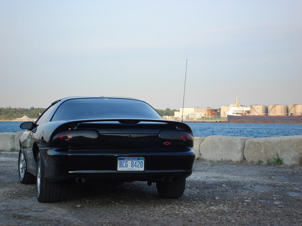

Just do it the cheap and easy way, gto covers
