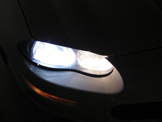

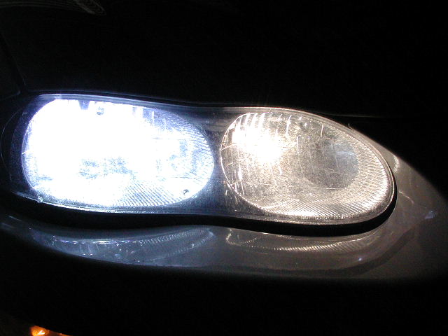

The GP was going on over at some Alero board. He sold 10 sets. And NO WAY will you get these kits for 300 on Ebay; if you think so, post a link. The kits that my boss is getting are the ones bringing between 375 and 450.
http://www.aldersgarage.20m.com/images/PC311582.JPG
http://www.aldersgarage.20m.com/images/PC311583.JPG
Those are 8000K in my dims and the "blue" lights in my brights...... And yes, the brights look blue if you turn off my HID's.
Ryan
