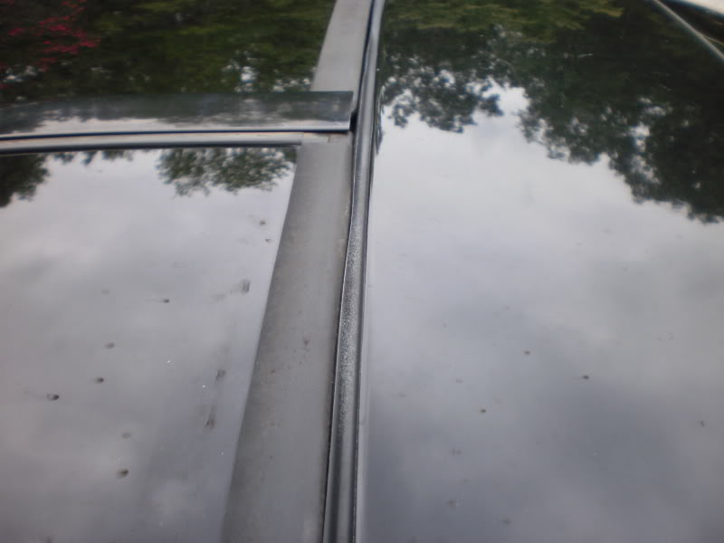

Did you seal the C-panel? Do you have any holes in it? You may have never even noticed if you haven't ...but look across and up from the side of the car while the tops are off. Do you have a gap under the C-panel between it and the rain channel? ....up high just under the top of the C-panel.
Old Aug 24, 2010 | 01:36 PM
The Captain's Avatar
Joined: Feb 2003
Posts: 649
From: Champaign, IL
I see what your saying. The factory T top piece comes down perpendicular where the hardtop piece does not, so it has a gap there. Go look at a factory T top car and you will see what I am talking about. It is molded into the C panel, so that whole piece would have had to been replaced. I havent had any problems with mine, and I did not seal it. Here are some pics:
I know my lines arent straight, I never got around to touching everything up. Its on the list...... I would just use some black RTV and call it a day. Go look at a factory T top car and you will see what I am talking about. Let me know if you have any more questions!
