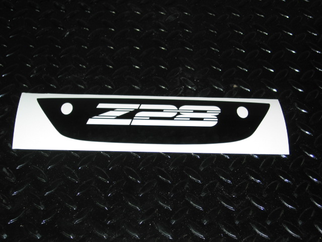

I just got a stencil for my Z-28 third brake light from bret franker.
He sent me an email saying to use the soapy water trick when applying it. I know he is a busy man so I dont want to bother him asking exact details. Is it like putting on tint. I thought I could just peel and apply. The stencil looks great by the way.

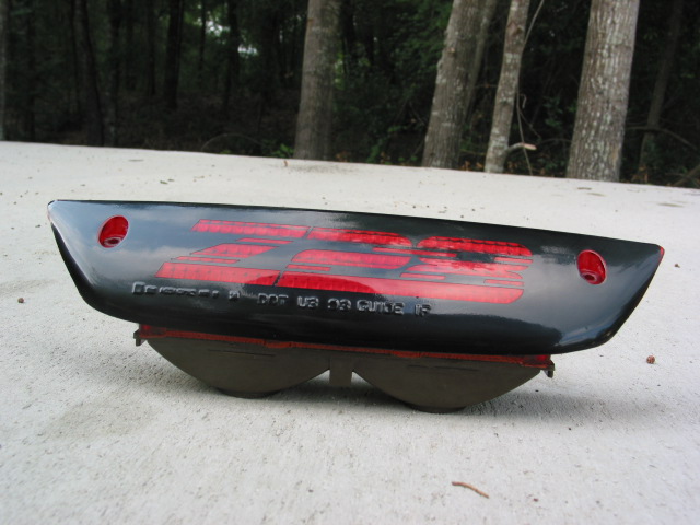

I *highly* recommend using some soapy water on these because you need to slightly stretch them and the soapy water will allow you to do this. Here is what I mean by the soapy water trick
Get an empty sprayer bottle. Preferably a new sprayer bottle but if using a 'used' one like a Formula 409 bottle or something then be sure it is cleaned out GOOD!!!. Take this empty sprayer bottle and put like ONE drop of soap in it. Fill it the rest of the way up with water. Don't get carried away with the soap... you'll notice that even with just like one drop it'll still suds up when you shake it.
Take the brake light out and clean it good with rubbing alcohol. Let it dry.
Peel the decal off its backing... it'll be stuck to the application tape. Soak completely the sticky side of the decal and the brake light with the soapy water.
Pick up the decal and gently place it on the brake light... use the two screw holes for alignment. When you align the two screw holes in the light with the holes in the stencil, it is in the proper place. Now that it is in the proper place, firmly press/rub with your thumb on the decal starting in the center and rubbing out to the edge. This will stick the decal to the light. You'll notice the edges may not be stuck very good... that's OK. Now work on peeling back the application tape... be careful not to peel the decal off the light when doing this! Once the application tape is removed, you'll most likely see some bubbles under the vinyl and it also won't be stuck real good around the edges. Now just work the bubbles out with your thumb by rubbing the bubbles to the edge. Rub the edges where the decal isn't stuck real good. Keep rubbing until all the edges are stuck and all the bubbles are out. This may take several minutes. Take a look at the pics below and you'll see how you need to slightly "stretch" the decal a little to make it a smooth fit... this is why it is necessary to keep rubbing it until it sticks good!
http://www.bfranker.badz28.com/vinyl/3rdbrake1.JPG
http://www.bfranker.badz28.com/vinyl/3rdbrake2.JPG
http://www.bfranker.badz28.com/vinyl/3rdbrake3.JPG
Let me know if you have any questions!
