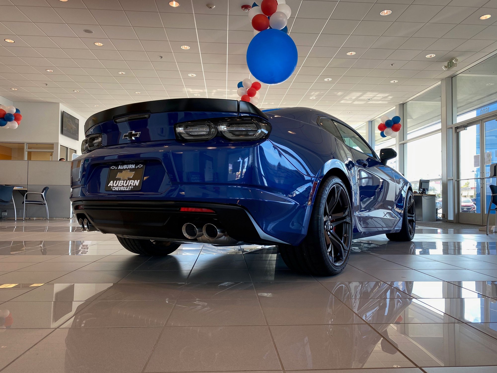

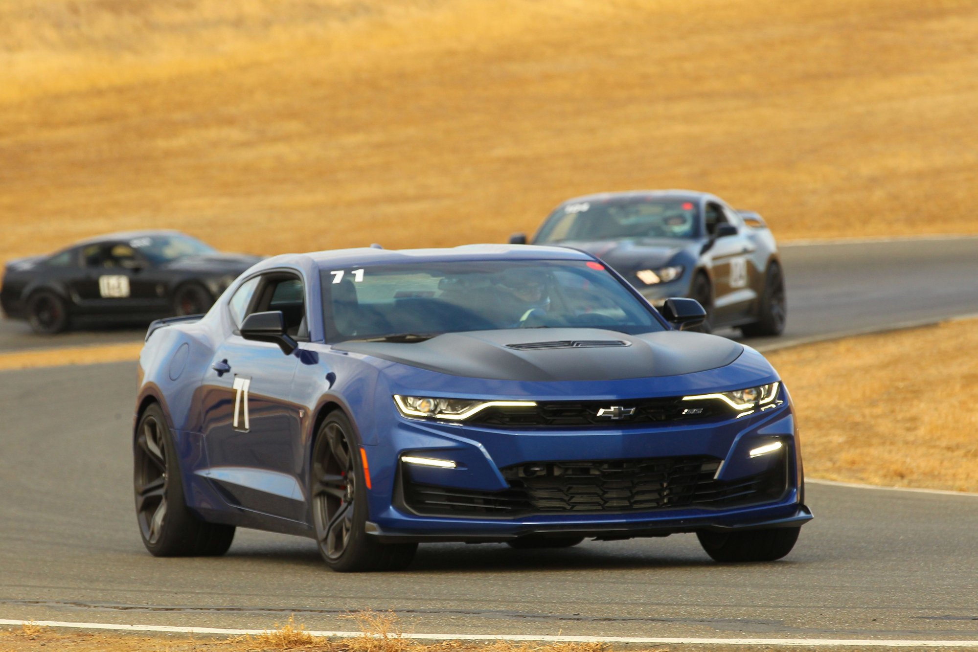

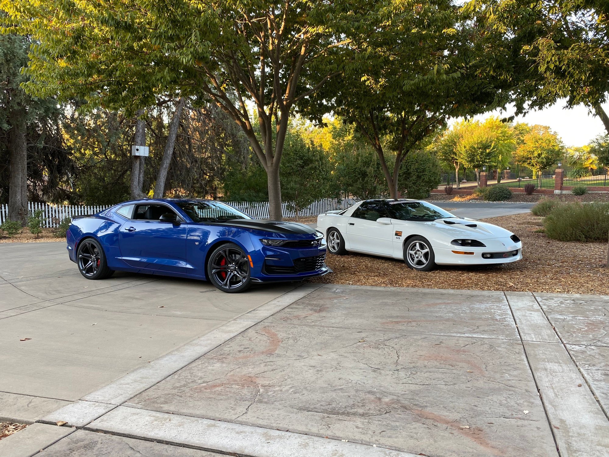

Flew to Washington, drove it off of the showroom floor, broken-in on the way home to Cali and shortly onto the track at Thunderhill Raceway. Chevrolet did an amazing job of testing, developing and fine tuning the suspension, brakes and tires on this car along with the ZL1.

Thanks! I love the color! A few people have talked about how heavy the 6th gen feels. Since you have track time on both platforms, what are your thoughts?

That was one of my main concerns. The new car is 240 lbs heavier than my '97. However 220 lbs of that is at the rear. So the actual front to rear balance of the weight is 54% front 46% rear. The '97 is 57% to 43%. Although any additional weight is not good I found the car is better balanced at turn-in. I am able to trail brake (brake steer) on turns. Also exiting turns has a feel of very controlled drifting. I was running race tires with a 50 treadwear rating compared to the new car with factory 220 treadwear tires and my lap times are almost identical. I still love driving my '97 but I enjoy driving to and from the track more often with the 1LE and a much shorter to-do list!
