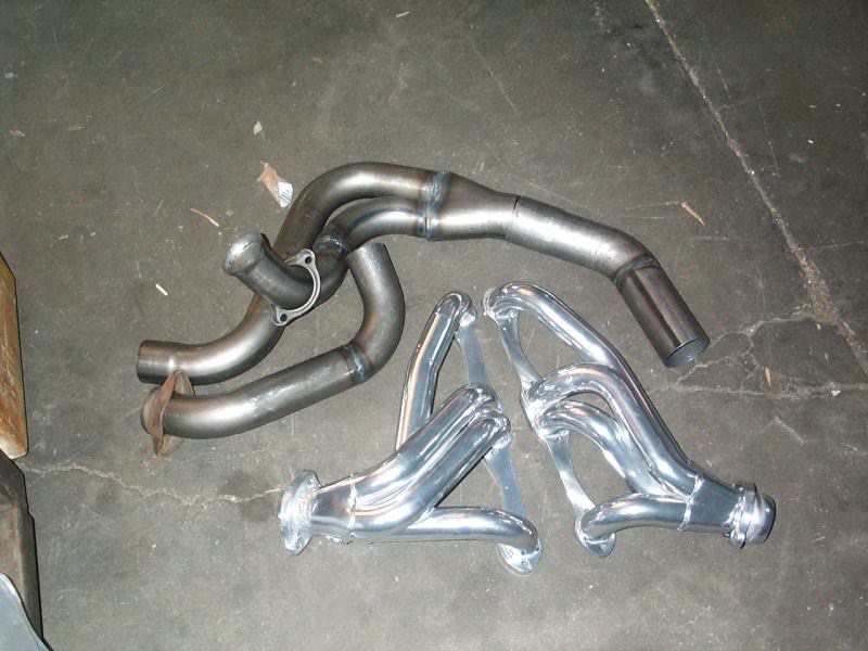

As far as I know, the Hooker 2055's only come in single cat versions. And they come with AIR whether you want it or not. They do install nicely though. If you still have the original dual cats, it wouldn't be much more expensive to switch to a single high flow cat when you do headers.
Personally I'd go for the Dyno Don headers. They come with or without AIR and you have the choice of single or dual cat versions. They're 1 3/4 primaries, 2.5" Y-pipe. One of the best features of them is the smooth Y-pipe junction where it goes from 2 pipes into 1. They're parallel in that regard. The Hookers are more of a T-connection there. Plug access is good and the performance is definitely there.
You'd need to get a hold of Dyno Don over on Thirdgen.org to buy these headers.
