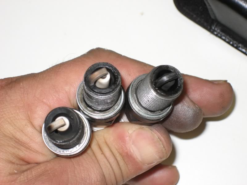

heres the 1,3 and 7 plugs. I suspected the #7 and as you can see it doesnt look like the others.
when i unclip the #7 injector the engine doesnt surge but doesnt sound right either like its running on 7cyl....but when i unplug the #7 plug wire its really sounds like crap.
these plugs are not old at all.....maybe 1000 miles at the most.
so whats up?

Does the vehicle start to idle rough only when it is heated up?
Many users on this message board talk about bad fuel injector being the cause of this problem?Does the car wants to die around 450rpm at idle, but seems to be fine while driving? Also does the car blow blue smoke in the morning when the engine is cold started?
