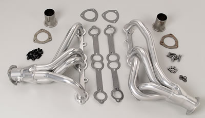

Summit is really weird with thier linking system...that just brings me to the Hedman Brand Category...but are these the ones you are referring to?
http://static.summitracing.com/globa...ed-68604-1.jpg
And as for the Y Pipe...well Hedman only makes one (on summit anyhow) so I know what your talking about there...but you say I would have $$ left over...Those Headers alone are 325$ and the Y-pipe is 98$. That puts me past the price of the Edelbrocks...please specify if there are different headers you are talking about that I am missing.
I also stumbled along a pair from Flowtech that are ceramic coated for 219$.
http://static.summitracing.com/globa...31116flt_w.jpg
Header Material: Steel
Header Finish: Ceramic coated
Header Style: Shorty
Primary Tube Diameter (in): 1 5/8
Collector Diameter (in): 3
Equal Length: No
Primary Tube Gauge: 18-gauge
Collector Attachment: 3-bolt flange
Flange Style: Standard
Flange Thickness (in): 5/16
Bolts/Studs Included: Yes
Gaskets Included: Yes
Reducers Included: Yes
Y-pipe Included: No
Quantity: Sold as a pair.
And the Matching Y-Pipe for 96$:
http://static.summitracing.com/globa...g-11102y_w.jpg
-pipe Inlet Attachment: 3-bolt flange
Inlet Diameter (in): 2.50
Y-pipe Outlet Attachment: Slip-fit
Outlet Diameter (in): 3.00
Y-pipe Material: Steel
Y-pipe Finish: Black painted
Oxygen Sensor Bung Included: No
Catalytic Converter Included: No
Gaskets Included: No
Hardware Included: No
Quantity: Sold individually.
Notes: Designed to fit FlowTech short-style headers. May require modification to connect to original exhaust.
Like I said, Summit is stupid, but those are the specs for those two. I may consider those, so tell me what you think about those too, if anyone has any experience with them.
Also, the question of the Nickel/Chromium headers rusting like the painted ones still exists if anyone else has input on that.
Thanks!
