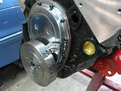

To check timing you'll need a timing light (unless you're old school and know how to listen to the motor... even then a timing light is highly useful to make sure). Behind the balancer on the crank (I forget which side but I'm thinking passenger?) should be a metal plate with a serrated type edge. That's your timing plate. You'll "shoot" the timing light in it and whenever you see the line across your balancer line up on that plate thats what you're timing is at. Adjust as needed. You can even play with turning the distributor (how you adjust the timing) with the light on so you can see how the engine timing changes. There's NOT a whole lot you can damage by screwing with the timing... the engine will just die if the timing is off (and could backfire/etc...).

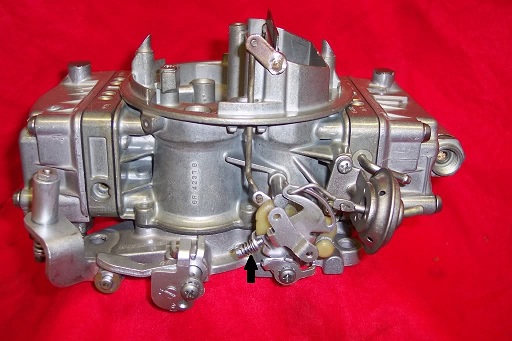

To check the idle set screw have someone in the car (it can be off for this, probably better if you don't know what you're doing) and have them push the gas pedal while you look under the hood (with the air cleaner off) and watch the carb. You'll see something on the side move (rotate). When you see it have your friend stop pushing the gas and look where it comes to a stop. There should be a little set screw there you can adjust (usually a phillips head), try turning it 1/4 turn in (clockwise) then start the car.

(and PLEASE don't crucify me if my arrow is a little off on the carb... I've been stuck fixing my wife's Ford Focus for the last 2 years and had to remove some of my carb memory to make room for the useless junk required to maintain her POS)
