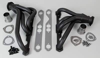

Don't go for the edelbrock headers...over priced imo. I also don't like the design either. If these are the ones you are talking about, then look at where the tubes collect at. They are all pinched closed.
I have a set of these on my IROC. They are the summit shorty headers. They flow so much better over the stock manifold, and they are cheap as hell @ $87. You cannnot beat that price. And look at the design compared to edelbrock...smooth sailing all the way through the collector. I know you said you want the biggest, but you also said you want the cheapest...well, these are the cheapest, and if oyu are taking them out soon anyhow to replace them...I would go with these.
