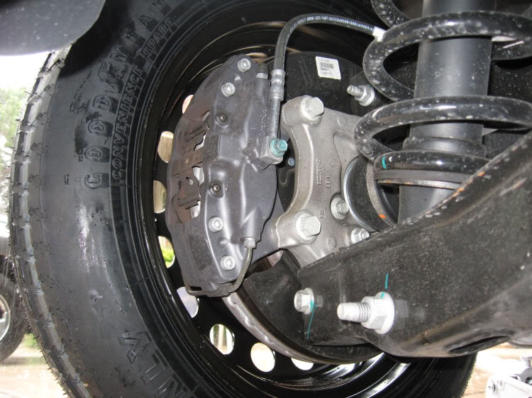

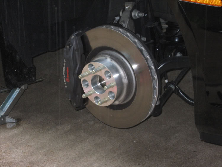

I just grabbed a full size SS rim they are easy to find and you can find a rim and a tire for around 200$ and a electronic scissor jack $65 would work good as well, its a less expensive option but Kendells kit looks stock and takes up less room. I wanted a full size so I can keep a decent speed especially for our canada trip , we ended up using the spare and cruised home at 80

Here's some pics of the kit, it does fit right above the battery on the SS model just like the LT (V6's)
