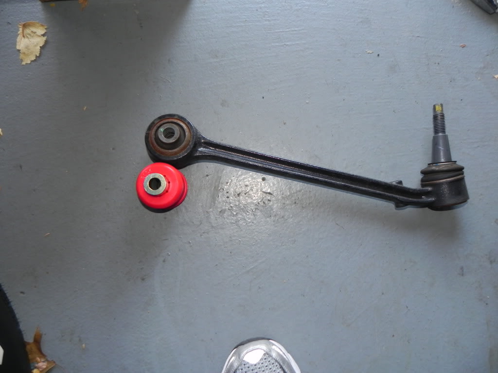

in the process of doing the brakes, i am also installing some bushing from pedders and BMR. up front i am installing the radius rod bushing and the lower control arm bushing from BMR. heres the lower control arm and the new BMR bushing

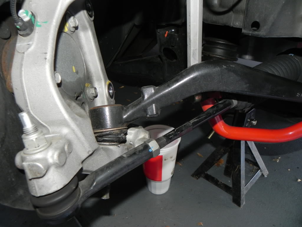

this is the very stubborn radius rod bushing on the passanger side. i think its going to be easier to take the radius rod out before the lower control arm, for the driver side.

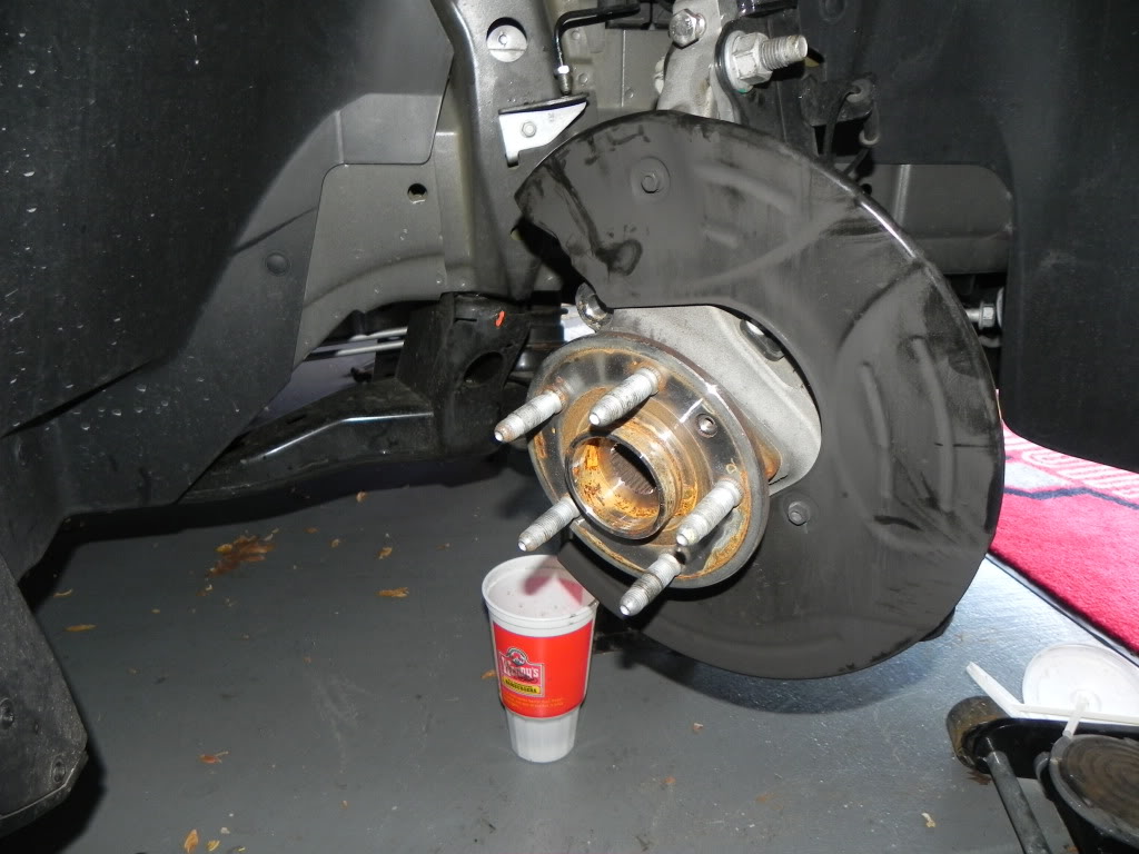

here is the driver side rotor and caliper off. only 2 bolts to take the caliper off and make sure you disconnect the brake line.
here the passanger side disassembled. notice the very hi tech container we used for the brake fluid to drip into.....

Cool. What's the secret to the radius rod removal?
Old Feb 28, 2011 | 08:53 AM
2010_5thgen's Avatar
Joined: Nov 2007
Posts: 4,482
From: ohio
Re: My CTS-V brake upgrade thread
theres 2 spots that you hit with a hammer and the shock waves shake it loose. you can actually see it in the second picture. there are 2 flat spots right below the ball joint. you hit those and it just drops out. now i need a new boot on one of my ball joints because the pickle fork tore it apart.
