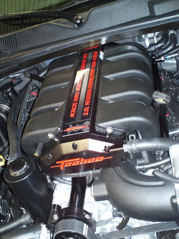

What the supercharger is all about:
The Revolutionary design allows air to move through the supercharger quickly and efficiently, without significant heat buildup, and at the highest resulting airflow volume at low boost output. The performance result is maximized horsepower and torque output.
Key Features of The TECHCO Reverse-Revolution Twin Screw Supercharger™.
* Reverse-Revolution Twin Screw Compressor with Asymmetric Multi-Lobe Screws
* 3.0L / 180 cu. in. Displacement
* Font Induction with Integrated Bypass
* 10 Inch Long Intake Runners
* Dual Stage Intercooler System with Single-Pass Coolant Flow through the A-Frame (2) Intercoolers, Large Capacity Heat Exchanger, High Volume Intercooler Pump and Recovery Tank
* Open Element Cold Air Kit with High-Flow Air Filter, CNC Venturi and High Flow Inlet Tube
* Extruded Aluminum fuel Rails with upgraded fuel injectors where applicable
* Separate 8-Rib FEAD (Front End Accessory Drive) with Dampener
* Ultra-Light Weight Aluminum Construction
* Flash Programmer

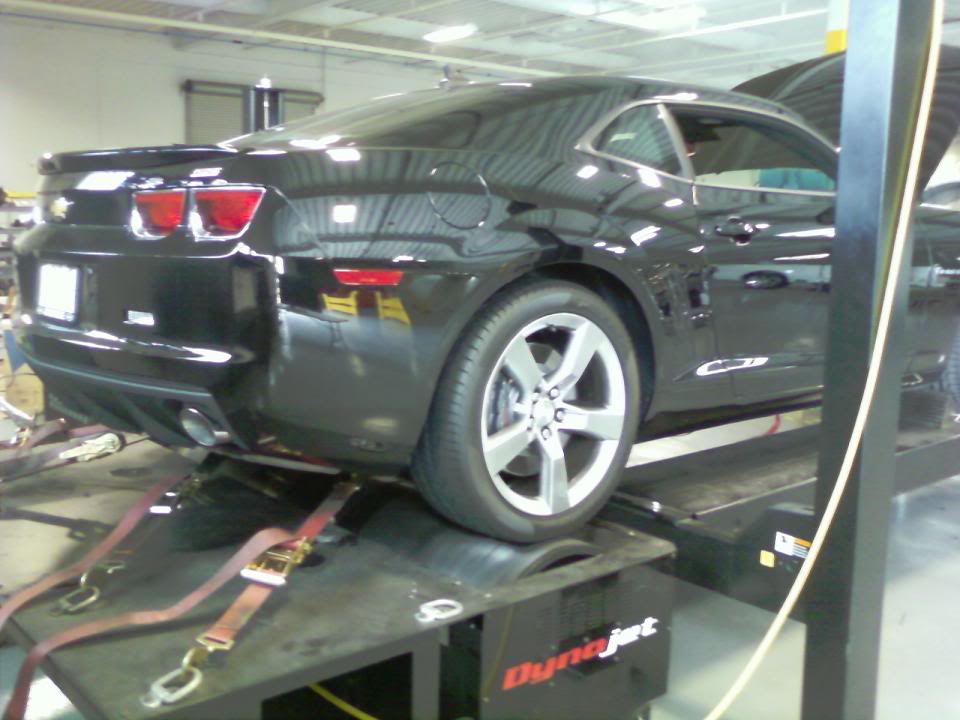

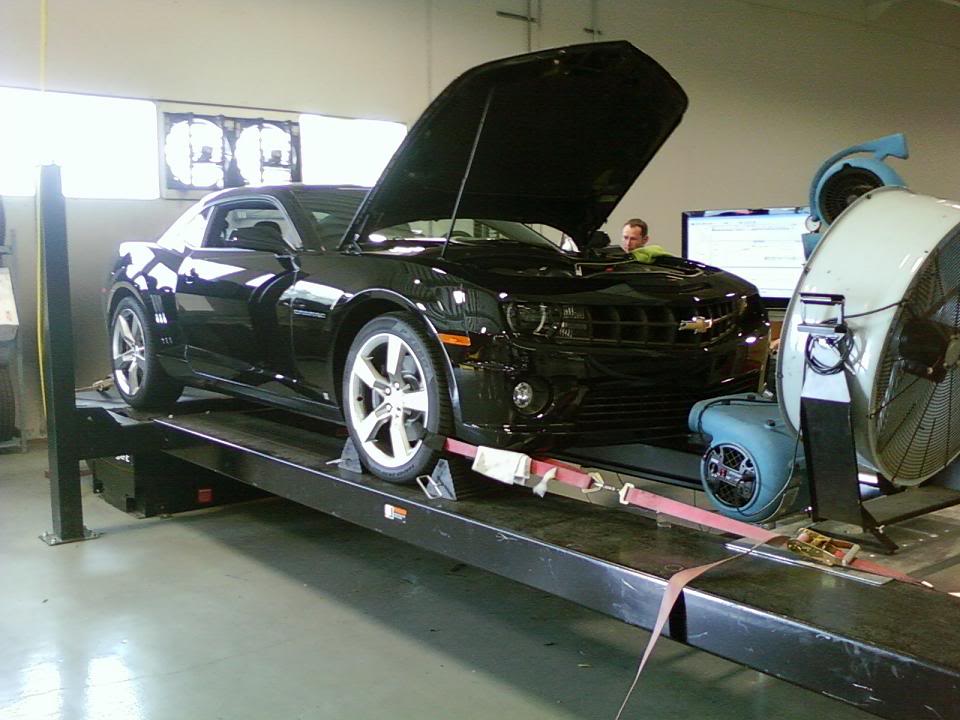

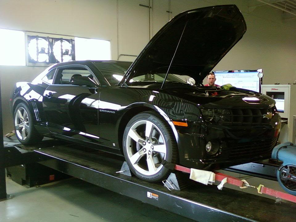

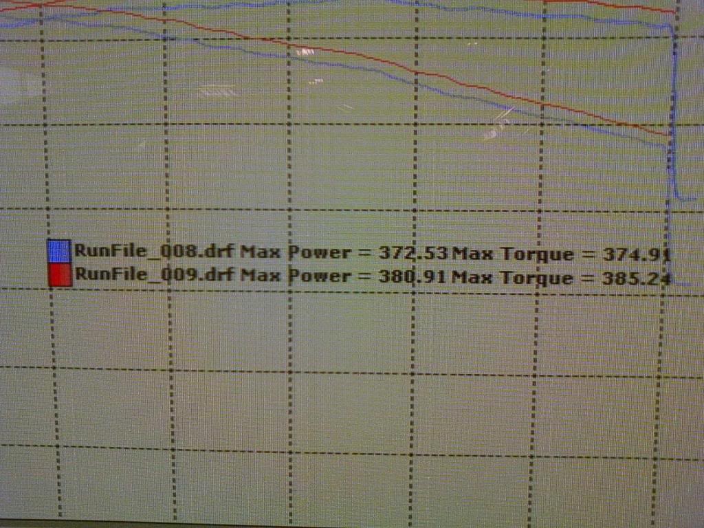

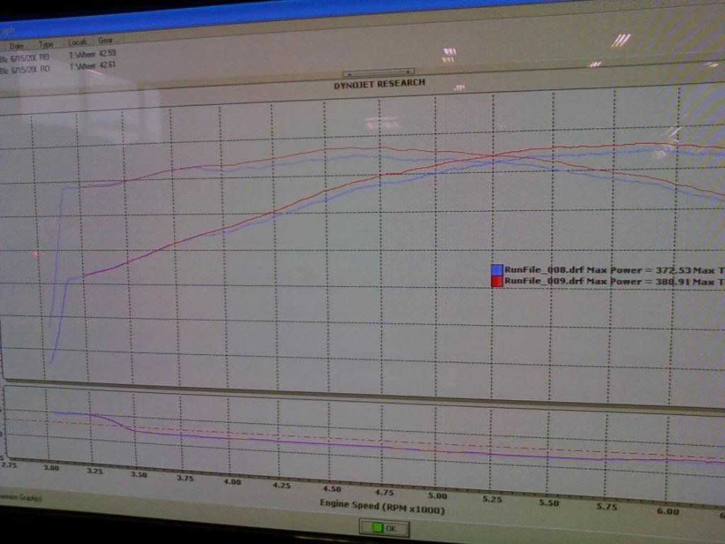

Here is some pics of me dropping it off and doing some Baseline Dynos. (Dyno power was 380rwhp and 385 torque on a Dynojet) Pretty impressive numbers!

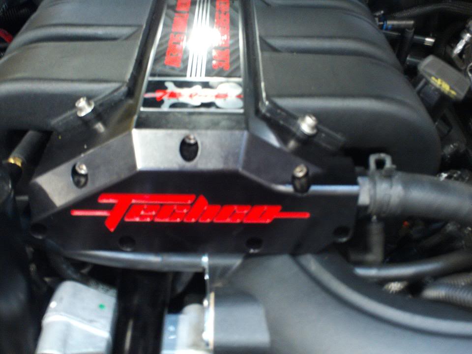

What the system looks like on a challenger

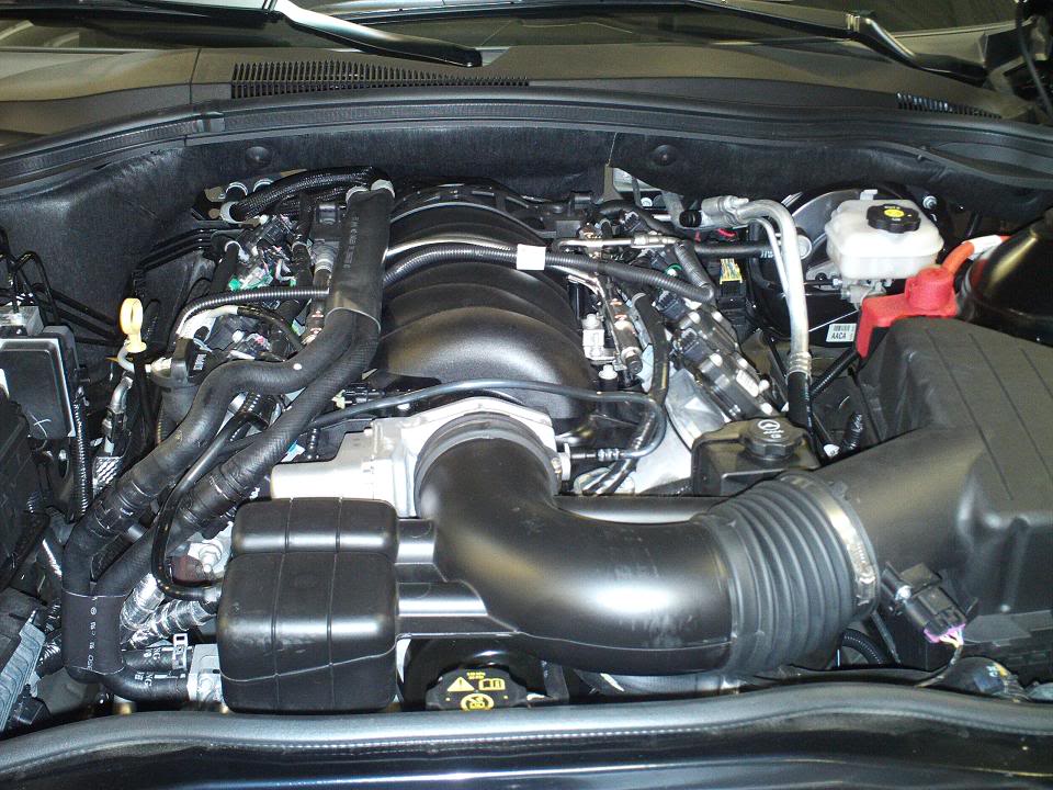

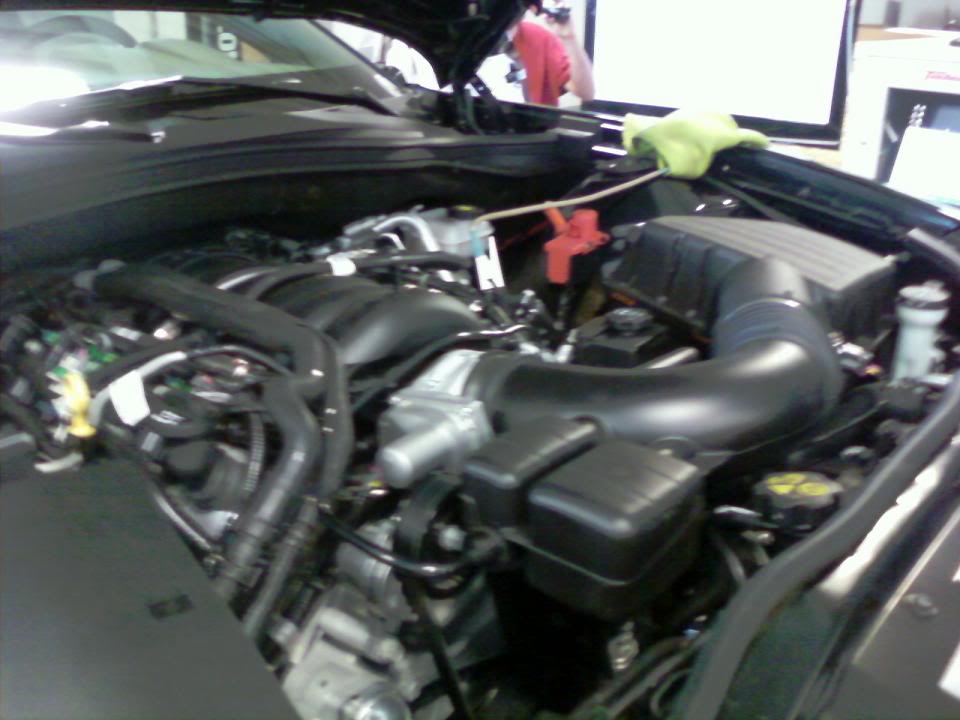

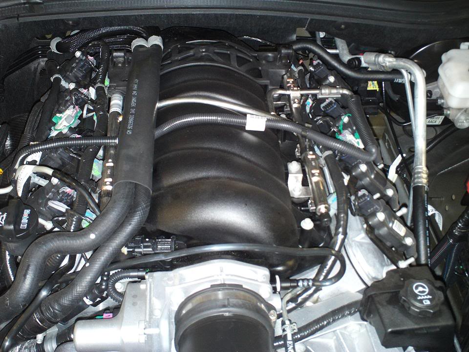

My Motor without the cover on
My car on the dyno

Dyno #s

that looks hella cool, but do you know what it sounds like?

It sounds like a kenne bell, you can go to there website and watch some vids

thats a nice looking supercharger. post the numbers after you get it all done. is there any kind of warranty with this company? how much does it cost?
