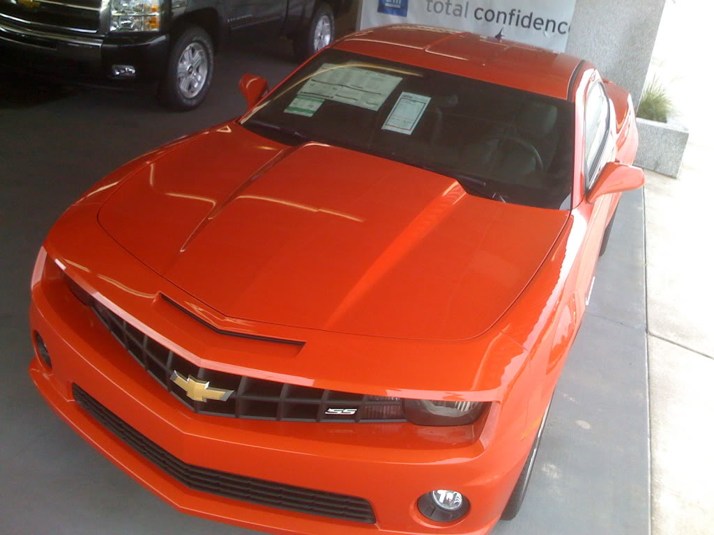

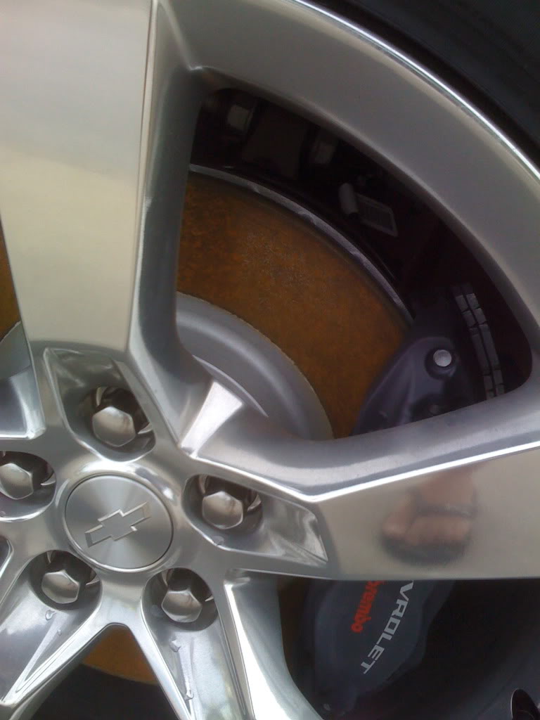

George Moore Chevrolet here in Jacksonville, FL got in a IO 2SS on Wednesday the 20th. I finally got around to getting up there and noticed that the brakes looked all rusted out. Whats up with this?
BTW, sticker was at $36,900. Not an RS, only 2SS.....

Thats because it hasn't been driven in a while. Just a quick spin around the parking lot would clear that off.

yep, rotors will do that quite often. If I dont drive my car for a week or so, rust may start to develop on the rotors, but it would be gone by the time I got to the end of the street.

Perfectly normal. Any rain or high humidity will do that to rotors. Try living up here in NH and watch everything rust after the road salt eats it. Living in the corrosion belt sucks.

Haven't you ever washed your car before? The rotors pretty much rust up right after you spray them. The more iron in a rotor, the more it rusts. Anyway, as the others have been saying, it will come right off.

Like everybody said, its perfectly normal. I detail for a dealership here and its customary to ride the brakes a little bit to get rid of the rust before delivering a car or putting a vehicle in the showroom.

It depends on the metallurgy of the rotors. Change the material a little, and they won't do that.
