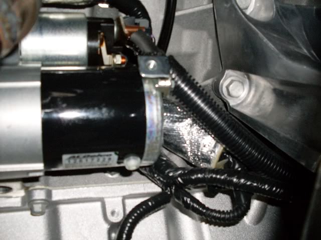

Image of battery cable positioned above starter:

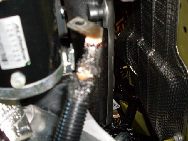

Image of cable looking up and aft:

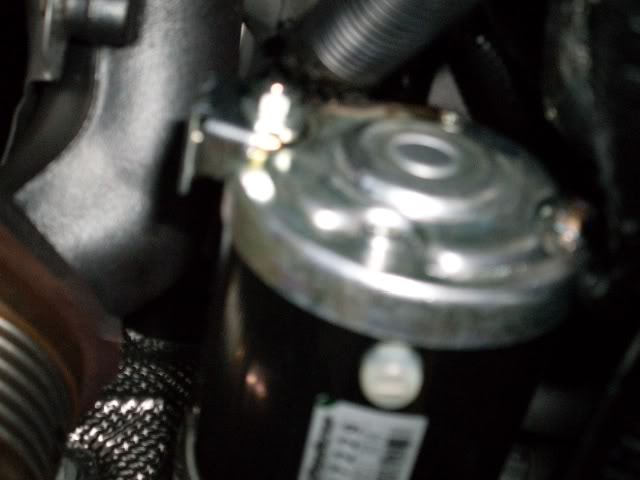

Image of cable disconnected:
