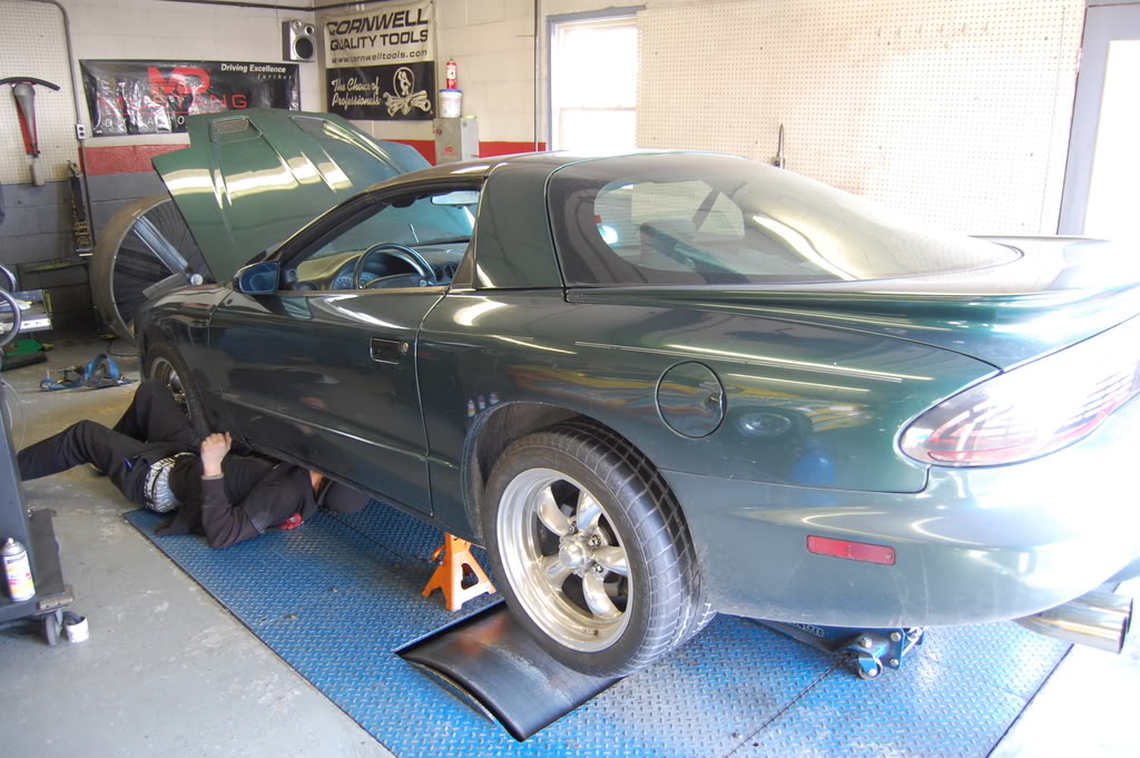

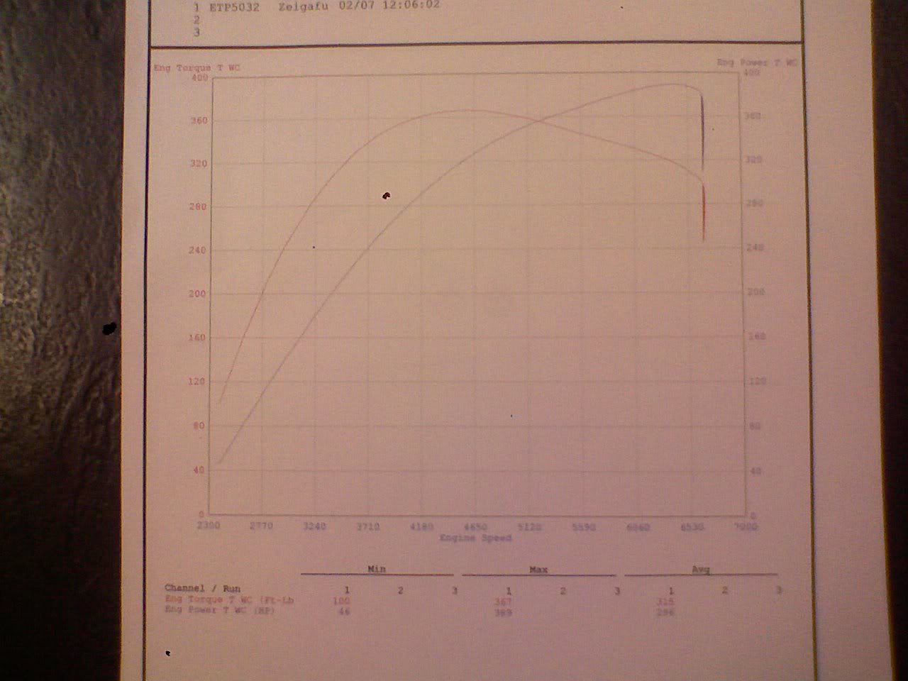

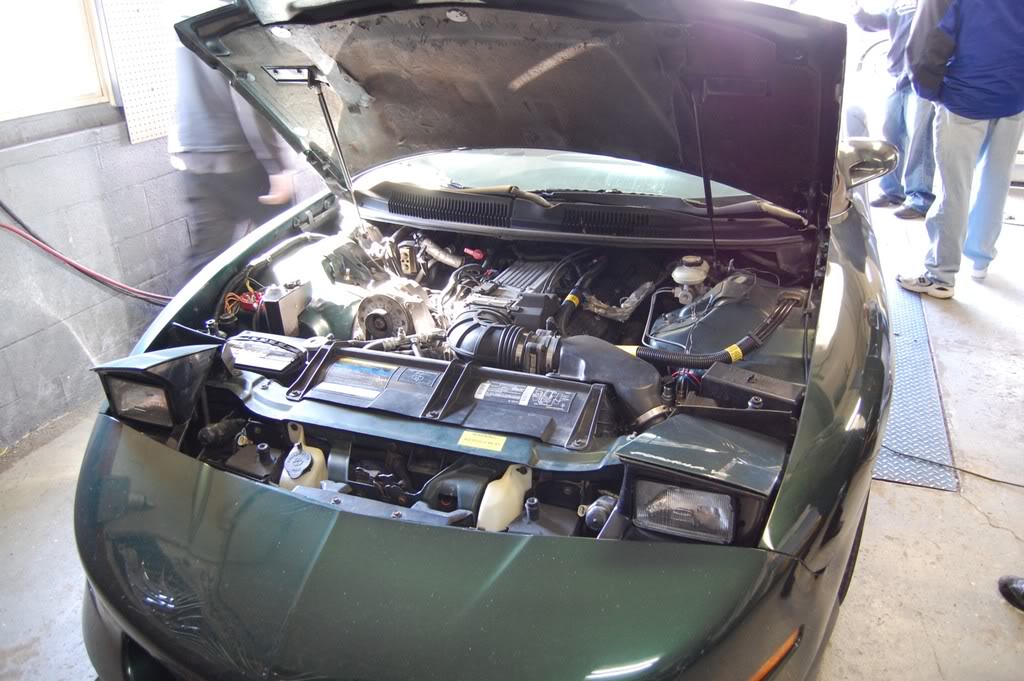

I put my car on the mustang dyno at PSI motorsports to see what she puts down as a baseline. I ended up making 365 rwhp @ 6400 rpm and 355 rwtq @ 4500 rpm. I have a stock airbox still so I pulled that and dynoed it again. it put down 389 rwhp @ 6400 and 366 rwtq @ 4500 rpm. amazing the stock airbox is costing me 25 rwhp.
dyno vid: http://videos.streetfire.net/video/P...ird_634625.htm
(excuse the guy recording, he is one of a kind haha)
crappy cell phone pic of dyno graph:

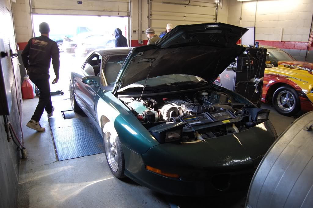

and finally some pics of the fun:

the tune is good but I am running out of fuel on the top end. with the stock airbox on I saw a tad under 14:1 A/F. with the airbox off it hit 14.6 at the end of the pull slowly leaning out. I am running stock injectors and I am sure they are maxxed out. I figured stock injectors would be OK but I really was not anticipating making this much power.

yes that was the shocker of the day, no one would have guessed until they got a real good look at just how restrictive the stock airbox looks.

i said this on ls1tech, you need a LS lid/ FTRA or SSRA setup. think the 25rwhp gains proves that.
I am curious to see what your heads would flow. I saw the pics of them but after what amazing f ing power they put down it makew me want to know even more.
