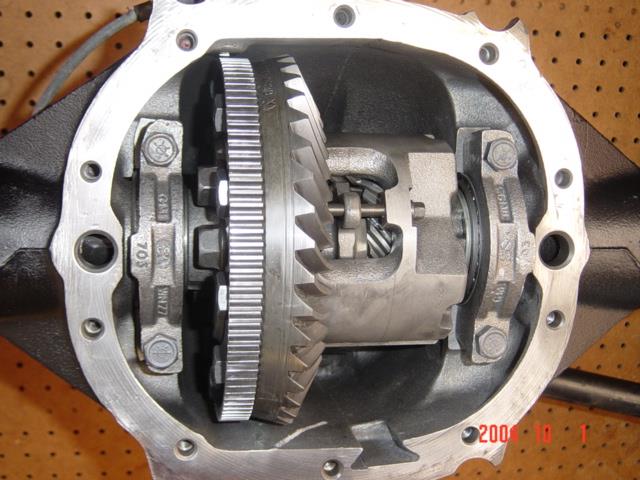

the reason it turns the opposite way is because it's not a clutch type limited slip. only the clutch type's or true lockers hold still. the torsen works alot like a gov-lock which will also turn like an open diff until torque is applied. if you pull the cover off, you'll find a torsen in there which will work the same pretty much as the auburn does in the older models.

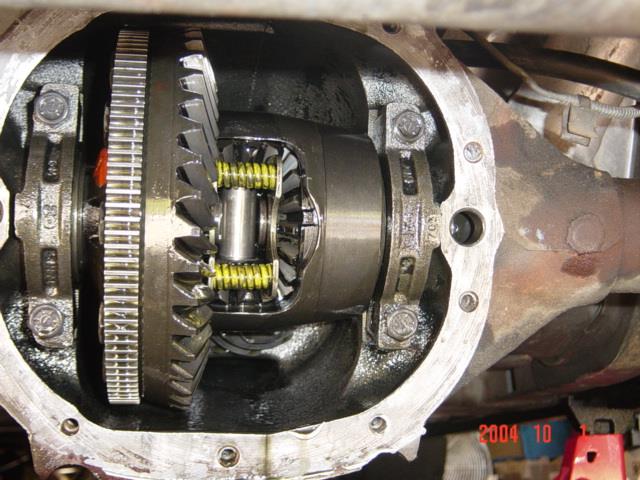

The torsen is a gear type torque sensing limited slip differential. It senses the torque difference applied to each drive axle. It has to be a significant difference. This differs from standard limited slip differentials in that they are a preloaded clutch type. They have different springs that increase the preload on the clutches. That is why your limited slip seems broken.

Here a pic of both types:
Zexel Torsion
Auburn Type
