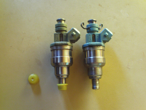

Ok, I went to smog my car about a month ago, and they said that I had aftermarket performance fuel injectors (came on the car when I bought it), and that I would have to get a stock set to make it pass smog.
So I got a used set from a 1994 LT1 (same year), and proceded to install them. When I pulled out the fuel rail I noticed the injectors looked alot different that the stock ones. "Performance injectors":
I also noticed that only 5 of them had the "yellow plastic nipple" on them
I got a flashlight and looked for them in the holes but all I could see was that the holes angle down in the intake.
I was hoping that maybe the guy forgot to install those 3 because they were very hard to get off the old injectors. I put it back together and started it, and now i hear a knock or a clunk about every 3 or 4 seconds.
So I guess those 3 "plastic nipples" are stuck in my motor somewhere causing havoc.
Where would they go? I only ran it for about 30 seconds and didn't rev it at all, Could it have messed anything up?

chances are the plastic piece has gone through the intake valve by now. as far as the knocking sound that should not occur from a small piece of plastic not saying it couldn't though......personally, i would take it for a nice long drive at different speeds.

Sorry if my post sounds confusing, but basically 3 of those yellow injector nipples fell in to the fuel injector holes. Would that damage anything?
The pic I posted above was of the aftermarket injectors installed on the car when I bought it. They do not have the o-rings on them because I will not be reinstalling them.
The stock replacements I got look just like the ones in userchemical's picture and do not have the yellow nipples.

Yes I am in California, but the injectors were definetly different than stock. They have Ford stamped on them
That doesn't mean they are performance injectors, but my car was running way too rich, so I thought maybe they flow more than stock.
I found the egr valve in the back was missing a vacuum line, hooked it up and now it seems to run fine with no knock.
I hope those yellow caps don't hurt anything. I think I will take your advice and take it on a long drive.

I seriously doubt that you would hear any noise at all from the plastic caps if they were in the engine. I think that is what you are asking.....not sure. The caps are hard as heck to get off....they would not be easy to lose. I had to replace a cracked one on my injectors(I dropped one and cracked the cap). For reference, I got the replacement caps at http://www.injector.com/fuelinjectorsaccessories.php. I got an O-ring replacement kit(Kit part number 1401).
SVO injectors are generally preferred for performance upgrades. They are good. I have 30# SVO's(red top) on my Z.
According to a google search, the blue topped injectors are 24#. This means the rating for our cars the rating would be 25.29# for GM pressures(for the calculation, see Injuneer's post mid page here....https://www.camaroz28.com/forums/sho...d.php?t=584413). Without the PCM being programmed for a 25.29 rate, the car will be running a tad rich.
Your injectors are also missing a plastic ring and o-ring too(see red topped SVO injector)....at the bottom(unless you removed them).
With that, I'd bet that they were installed without the caps.
You need to get the o-rings back on the injectors with the plastic spacers. Without them, you have a serious manifold leak....which will make the car run like crap.

Aren't the plastic caps he's refering to called pintales and they are supposed to be there to aid in the spray pattern? All of my SVO's have those on there and when I sent them off to be cleaned and flow tested they replaced them with new ones.
The "pintle" is a small rod in the injector, that is moved in and out to open and close the injector. The plastic cap is not the pintle (or "pintale"). Its a cap to protect the end of the injector, and reduce the formation of carbon on the tip of the injector, when it is exposed to the heat from the combustion chamber, when the engine is shut down and an intake valve is open. That is one of the areas where a pintle style injector has more problems than the factory ball/seat injectors, because the moving element (pintle vs; ball) is closer to the tip of the injector.
Anything plastic that fell into the head intake runner, and most likely found its way past the intake valve would have melted and burned up.
